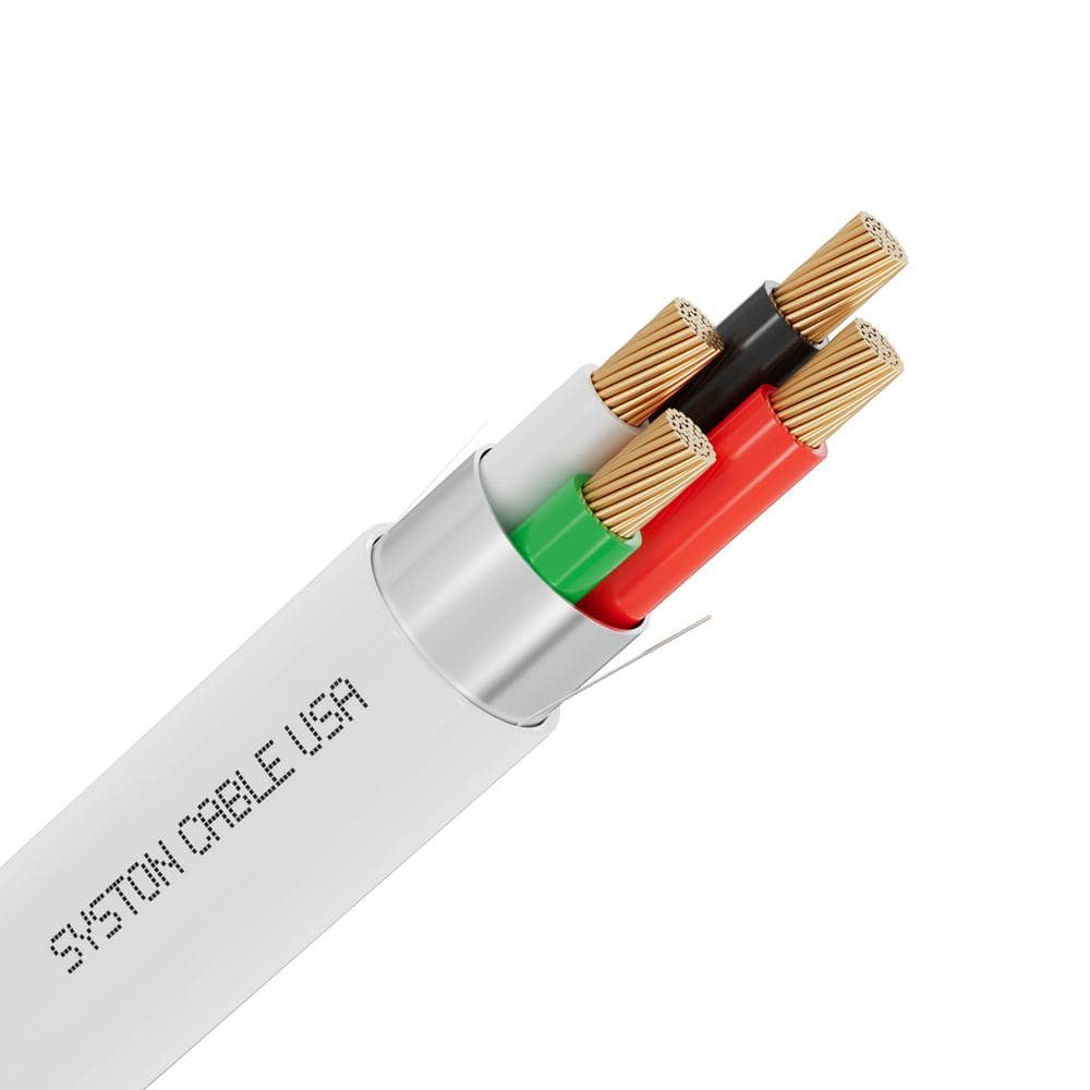

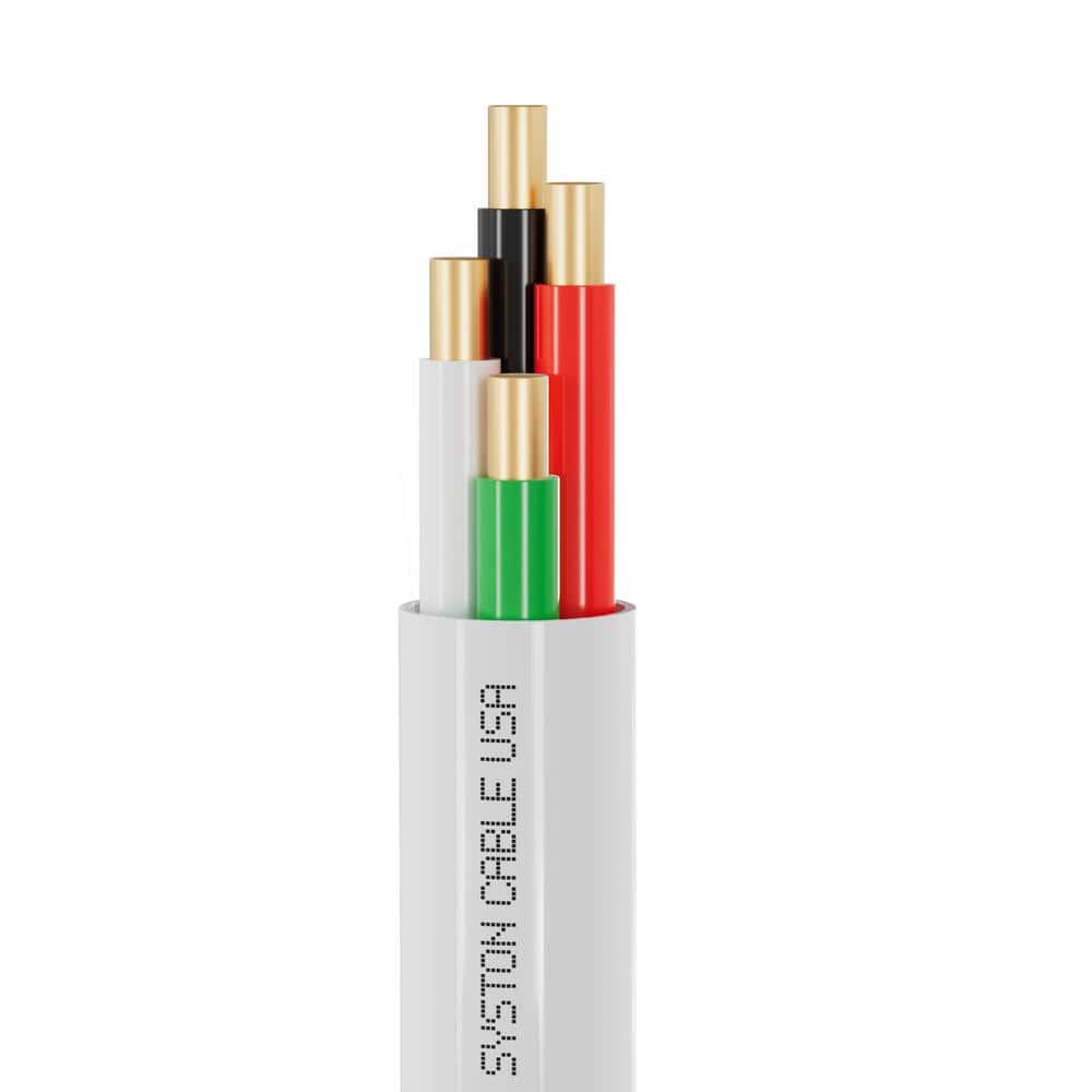

Looks like a wire and a piece of plastic.
The HLX485100 (100 ft.) and HLX485200 (200 ft.) are extension kits designed to extend the range of the Control Pad from the VS Omni or OmniHub wiring hub.
