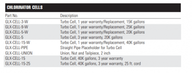

Is there any difference between GLX-CELL-15-W and TCELL940-W ? Are they identical inside with different label or the 940 version will last longer? I understand they both have 1 year warranty.
The 940 is a long life version of the T-15. I don't know for sure if the replacement cells are the same or different.
The T-CELL-15 is selling for a lot more money compare to the W3T version, just want to make sure they are identical and both have same 3 year warranty?
As far as I know the T-CELL-15 is the same as the W3T-CELL-15 with the same warranty.
For some reason, they added the “W3” to the front of some products, but I don’t know why.
Some references show a 1 year warranty.
The website for Canada shows a 1 year warranty.
I don’t know for sure if there are actually some cells with a 1 year warranty or if it is a typo.
Hayward seems to be all over the place with their information.
Before buying, verify all details including the warranty and ask for the first 4 characters of the serial number to verify the warranty period and the year manufactured.
Since the website says "3-year warranty" with no conditions or exclusions, then that has to be the warranty, in my opinion.
If there was a 1 year warranty model, then they need to say that.
If someone looks up the cell on the official Hayward website and it says 3 year warranty and then they rely on that to make a buying decision, then it would not be fair if they receive a 1 year warranty model unless the seller explicitly said that the warranty was only 1 year.
Even if the seller said 1 year warranty, Hayward is the manufacturer and it is their warranty. So, they decide what the warranty is and a seller is not authorized to change the terms of the manufacturer's warranty.
If the seller wants to say 1 year warranty, then they have to cite official manufacturer documentation where it is the manufacturer's official policy.
