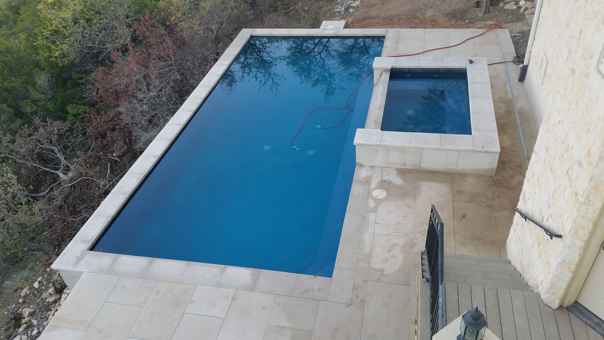

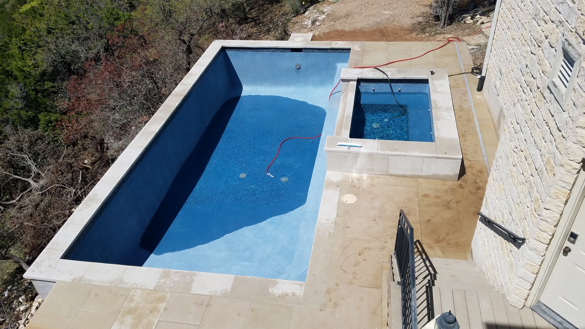

Here is a picture.

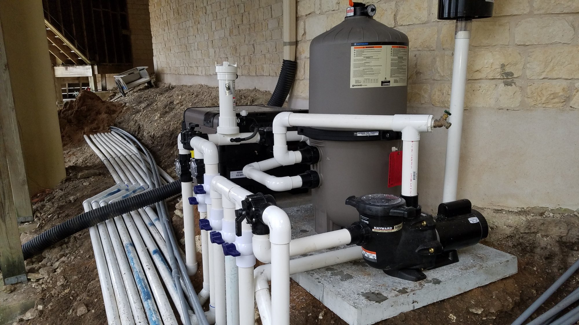

Can you show the whole pool and system?
Do you have and ionizer or a mineral cartridge?
Have you used copper or silver algaecide?
Can you remove the filter cartridges and show them before and after cleaning?
Try the stain ID kit.
Maybe the tab feeder is back feeding chlorine into the heater.
Are you feeding something else through the tab feeder?
If yes, what?
Is the peristaltic pump for acid or chlorine?
