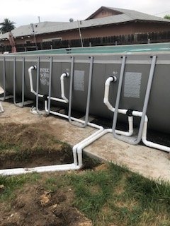

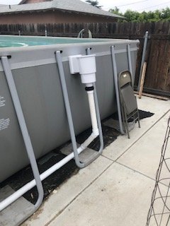

Hi! I did mine last year and it worked great for winter close and this years spring opening,
Please note I used the wrong elbows they should be rated for pressure I apparently used drain pipe elbows. I’m running on low speed right now and have no issues. I definitely recommends the valves and unions. Make sure you don’t get glue on the Union threads.
Reactions: Donah
Me Too!!! Very Happy. Not too difficult, just time consuming. Don't rush your PVC joints. Take the time to let the glue set. The TFP members were a big help to me while I planned. I was terribly annoying with the questions, but they didn't let me flounder. Yes, be sure not to use Drain Pipe Elbows. The 90 degree sweeps I used were for pressure. Found them at a local, independent, pool supply store near me.....Make a drawing with measurement, ask lots of questions and buy a couple more of everything than you think you'll need. You can always return what you don't use...Lean into it, you'll be fine....
