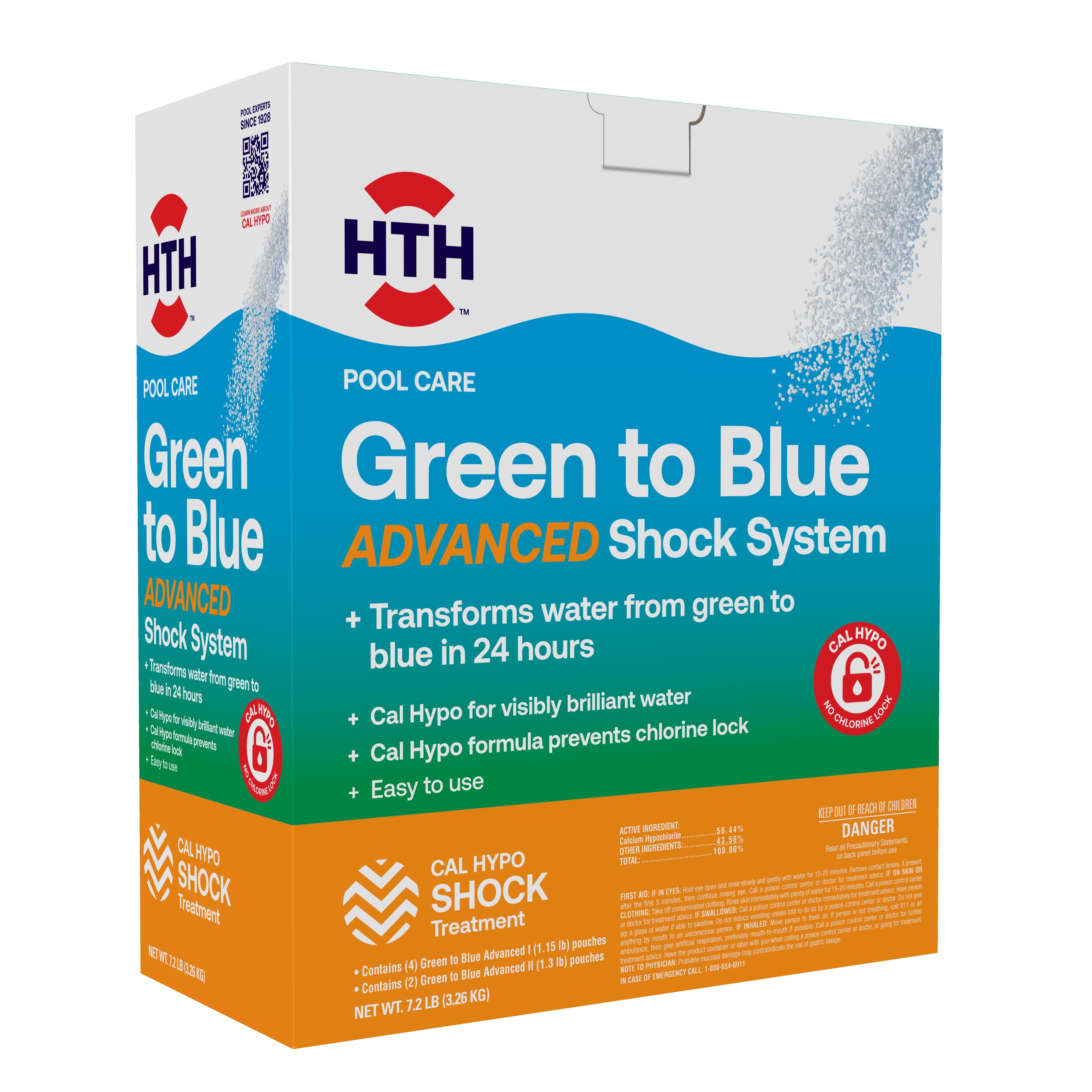

Hello , My Name is Jose and I'm new to this Forum and also new to Pools in general. First of all Thank you for allowing me to join this forum. A few months ago I renovated my unground pool with pebbles aggregate. The other day I noticed Algae started to grow and I went and bought HTH green to blue product. Well Not knowing much about the product and pools I followed the instructions however I made a mistake to poured the flocculant directly to the water and not to the skimmer. the problem I do have is that apparently the flocculant has got stuck in the bottom of the floor since the agreggate is rough and not even vacuuming the floor I can't get some of the flocculant out. I even tried to brush it off but it doesn't come out completely leaving some patches of that mustard color in it. Can you please help how to remove that from the floor without damaging the pool? BTW I Do have a D.E filter and first I changed the valve to waste I Switched it to filter after realized it was draining the pool faster than I could fill it with the hose, right after a while I cleaned the filter and I put it back on filter again. Thank you in advance.

Welcome! It looks like that product is just overpriced cal hypo so it’s not flocculant (which is good because you don’t want to use flocculant).
Maybe someone else can explain why it sticks to the floor but I had a similar experience adding calcium (calhypo is half calcium) and I had to spend a good 20 minutes stubbing the floor to get it to come up even though I started brushing right after I added it. I suspect you’ll just need to keep brushing, if you can get in the pool and scrub by hand with a rough sponge it might go faster.

Sorry I’m not understanding. The green to blue product you mentioned is not a flocculant. So what flocculant did you add?

At lease that's what it says in the 2 bags that comes with it:
  • HTH® Pool Care Green to Blue Advanced
Pool Calculator
Find Your Pool Size
Fight severe algae bloom and transform your swimming pool water from green to blue in 24 hours with this easy-to-use system.
  • Simple 2-step system contains:
    • 4 bags of Pack I - a strong algae-fighting pool shock utilizing Cal Hypo
    • 2 bags of Pack II - a powerful flocculant that binds algae particles together and drops them to the pool floor for vacuuming to waste
  • Pack II, flocculant contents appears brownish-orangish, which is normal
  • Not for use with cartridge filters
  • To use effectively, your pool must have a multi-port valve with a “waste” position
That's the product I put in the pool. BTW there's still stains left from the product I can not remove.

Ok, that’s the confusion. Those two products someone bundled in a “kit”. Is all the floc out of the water now?

Oh no , I was abled to removed most of it as advertised but a lot of small areas they don't come off even with a brush. It's like that Floc stained the pebbles with that mustard color in some areas. When I called HTH they recommended to add another product that remove metal out of the water but I was sceptic about it and didn't use it.
