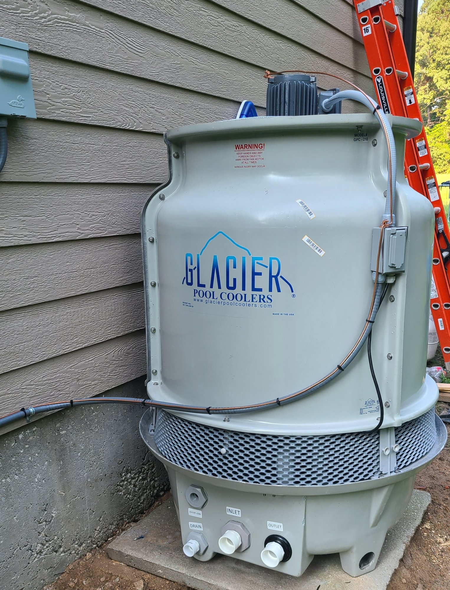

Also, the manual also does not mention bonding. I called them and the tech that I spoke with said all you have to bond is the metal shroud/fan motor at the top as that was all the metal in it. I asked about the sump pump and he said all the internals that pump water as well as the top and bottom of the pump are polymer and nothing to bond. I pressed the issue and he said that you could bond the aluminum switch box that runs to the pump and that is all that has ever been required...so that is what I did. I had to add bonding lugs to the motor and the switch box. You can see good in the first picture of the chiller that I posted above, post #30.
