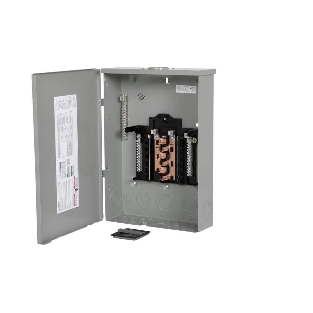

I was thinking about this yesterday, and realized that they offer these filters with many different L/C values, and that I could probably pick one much more suitable than the first one I grabbed off Amazon. But, since I already need to lay out a new and larger panel board to hold a SWCG controller and some timers, I am just going to use it as an opportunity to switch everything over to Siemens.
It irritates me that Siemens doesn't make a nice tall/narrow 6-slot lugs load center like Cutler Hammer (CH), Eaton (BR), and Square-D (QO) all do, but I'll just make the new panel large enough to hold the Siemens 4x2 = 8-slot load center.
