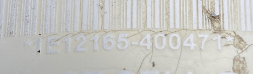

I don't have the box and the Serial Number on the cell is difficult to see as it has faded (see image) but I think it says: 1E12165-400471.

GLX-CELL-15-W
Wow, how did you know that?
The "W" at the end means warranty replacement cell.
The cell was made on the 165th day of 2012.
At 10 years old, I am surprised that it is still working.
