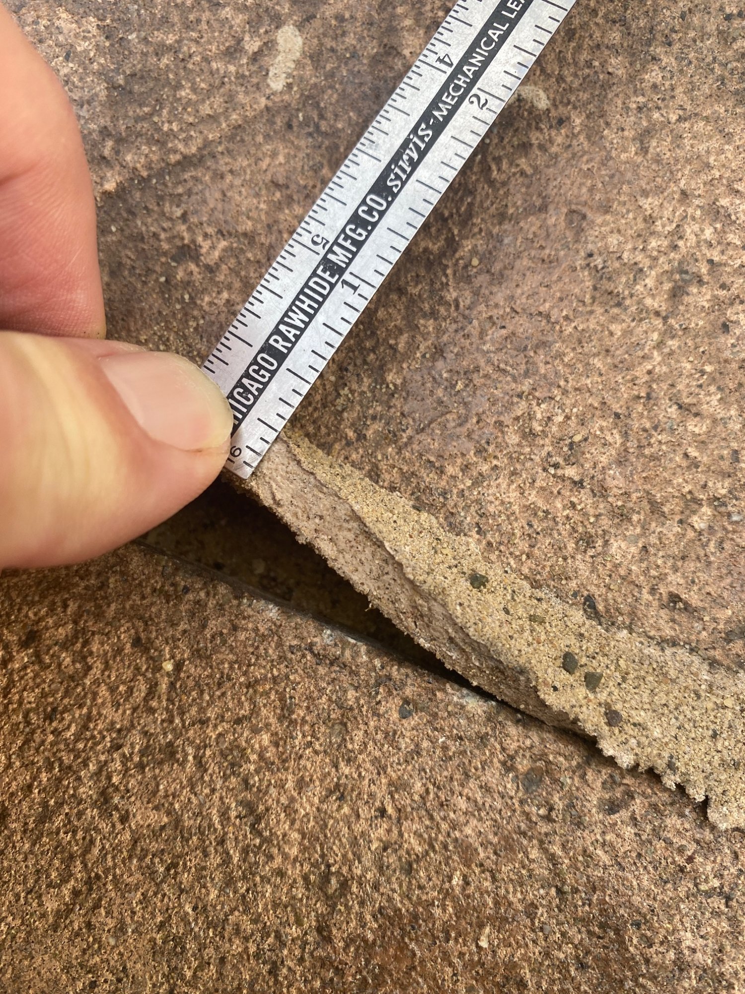

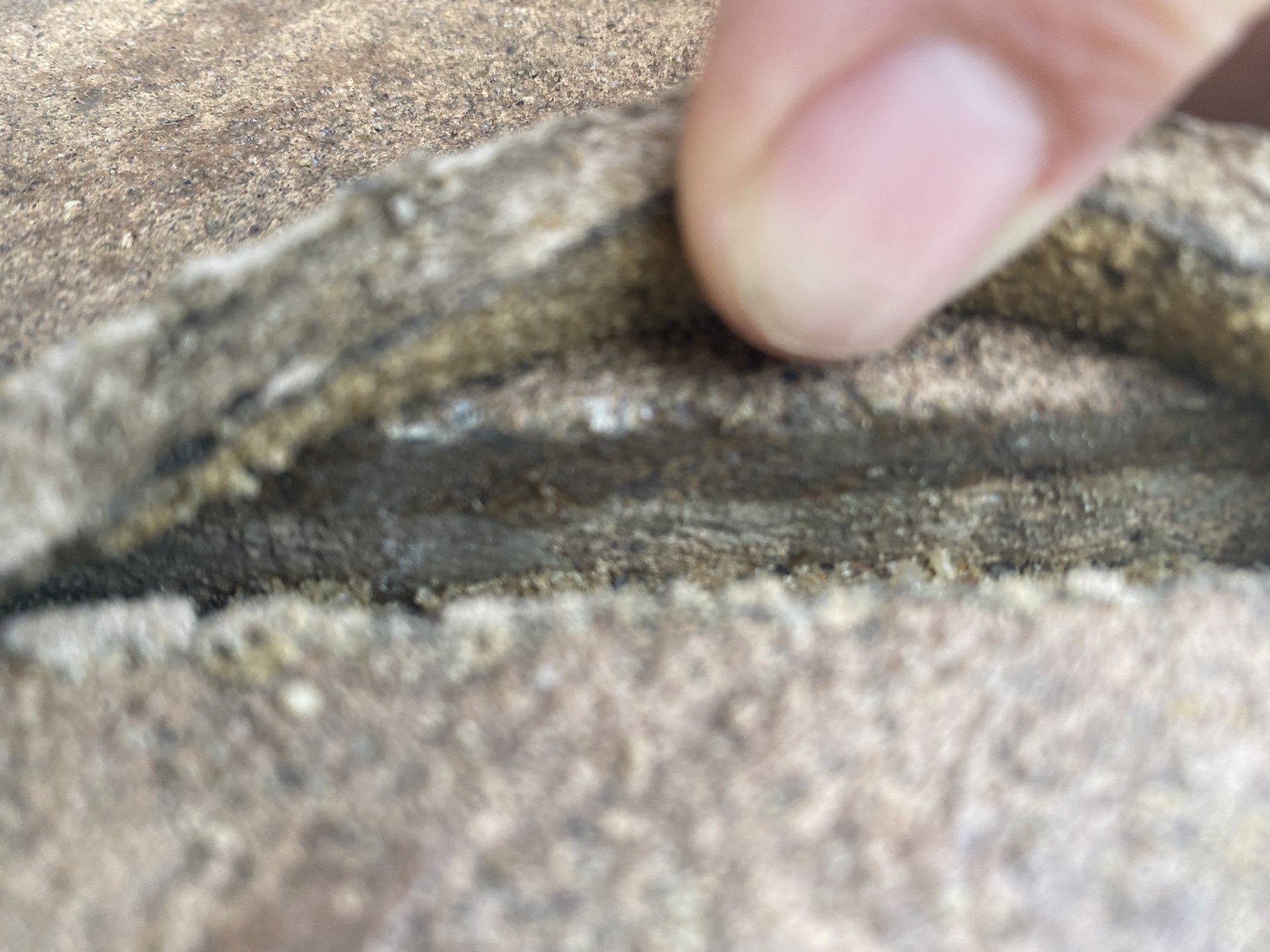

The bigger issue you may have...if your deck has been sealed, particularly with acrylic sealer, sikaflex will not adhere. Here is an example....
