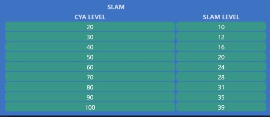

Once the CYA is down to about 50-60 "ish", then you can begin going after the algae via the SLAM Process. You'll use strictly liquid chlorine to maintain the proper elevated FC level for the SLAM as noted on the FC/CYA Levels. I'll post an easy to read chart below shortly. But if you follow the SLAM Process properly until completing all 3 criteria, you'll kill and remove the algae.

Here is an easy to read chart about the proper FC level for the SLAM Process based on your CYA. So after you exchange a bit more water, take your new CYA number and go to this chart. Then maintain that corresponding FC level until you pass all 3 SLAM criteria. Follow the SLAM page carefully. :goodjob:
