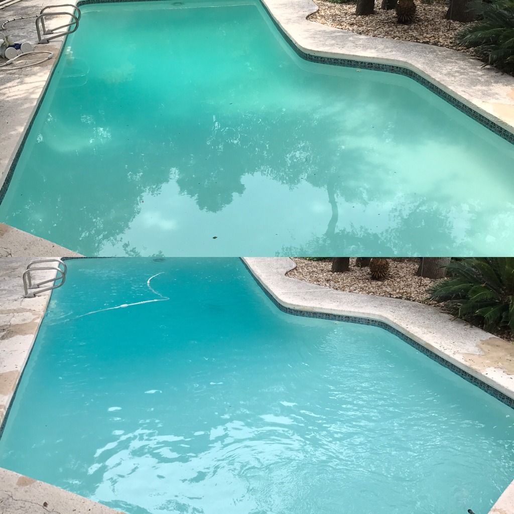

Here is a couple days ago (top) vs about 6 hours after SLAM start and refills (bottom).
You can't run the filter overnight if it's rising that fast. The best option is to run on recirculate, if that is an option, when you can't watch the pool. Keeps the water circulating at least.
