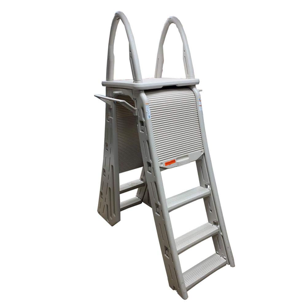

I did this last year when the steps were in the pool, I posted info and not so great photos of it in action. The steps should go in later today and I wanted to post these as a way to keep steps from floating. I wish it was my idea but I stole it from a photo I saw on-line somewhere. My steps are the Confer 1X step system with the locking gate, center platform and spindles; I imagine this should work on similar steps.
This is the back of the steps and I installed 2 loops of plastic pipe hangers onto the stairs. I filled the jugs with pebbles and I cut the PVC pipe shorter than the width of the steps.
Then I just slid one end of the pipe into one hanger, slid the handles of the bottles onto the pipe and then slip the other end into the other hanger. It really keeps the steps from floating.
Really easy to do assuming the steps aren't already in the pool!
