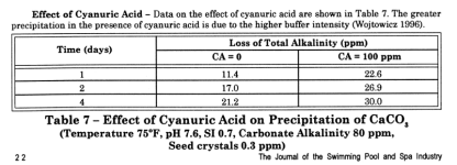

d) At a given initial pH, SI, and carbonate alkalinity, the extent of precipitation increases with increasing cyanuric acid concentration due to increased buffer intensity.
C and D do not make sense to me.
The extent of precipitation should increase with increasing pH.
The extent of precipitation of calcium carbonate should decrease with increasing cyanuric acid concentration because the cyanurate alkalinity replaces the carbonate alkalinity lowering the carbonate alkalinity.
Added CYA also reduces the pH, which lowers the rate of calcium carbonate precipitation.

The data show that CaCO, precipitation increases with increasing alkalinity at a given SI and decreases with increasing pH.
The change in precipitation with alkalinity and pH is due to a change in buffer intensity which varies directly with alkalinity and inversely with pH, in agreement with calcium carbonate precipitation potential (CCPP) theory (Wojtowicz 1996).

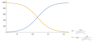

At a pH of 7.6, you have 99.8% bicarbonate and 0.2% carbonate.
At a pH of 8.2, you have 99.2% bicarbonate and 0.8% carbonate.
The precipitation of calcium carbonate depends on the concentrations of calcium and carbonate.
The amount of calcium ion stays constant and the amount of carbonate ion is increased by 4 times.
4Ca2+ + CO32- --> 3Ca2+ + CaCO3 (pH = 7.6).
4Ca2+ + 4CO32- --> 4CaCO3 (pH = 8.2).
998HCO3- --> 2H+ + 2CO32- (pH = 7.6).
pH.....Percentage that is carbonate.
7.0.........0.05
7.6.........0.20
7.9.........0.40
8.2.........0.80
8.3.........1.0

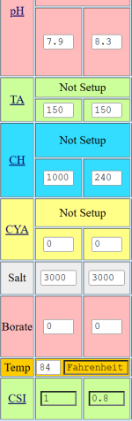

To make the CSI equal for different pH levels, you need about 4 times the amount of calcium to compensate for the 4 times difference in carbonate.
So, you are comparing a calcium of maybe 240 vs. 1,000 ppm, which is not a fair comparison.
Effect of pH and Alkalinity on Precipitation of CaCO, -
The total dissolved solids was adjusted to 3000 ppm with NaCl.
Hardness was adjusted with calcium chloride to provide the required saturation indexes.
Ten ml of a 0.05% calcium carbonate slurry was added to each tank and stirred to homogeneously disperse the seed crystals.
Also, if the pH starts at 7.6, it will naturally rise due to CO2 offgassing and the pH will be higher by the next day (Maybe 7.9).
If the pH starts at 8.2, the pH will not rise very much due to the very low level of CO2. The pH might rise to 8.3.
So, you are not making a fair comparison.

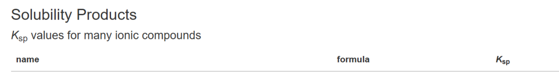

The solubility product constant (Ksp) for calcium carbonate (CaCO3) ranges from 3.36 x 10–9 to 6.0 x 10–9, depending on the form of the calcium carbonate.

In any case, I would say that the most important thing is to track the CSI in PoolMath to make sure that the plaster is protected from etching and from scaling.
(Total Alkalinity/100086.9) = (0.5)X + Y
X = (1 - (1/(10^(10.3-pH) + 1)))(X + Y)
Y = (1/(10^(10.3- pH) + 1))(X + Y)

From PoolMath increasing the pH, CH, and TA will all increase the CSI, increasing the CyA, Bor, salt will all decrease the CSI. A decrease in temp will decrease the CSI.
