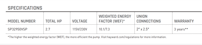

If you are wedded to Hayward...the Tristar 900 VSP is a great pump and can be run 115v or 230v.
The 950 can also be run 115v or 230v.
