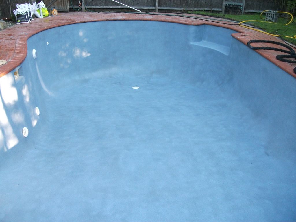

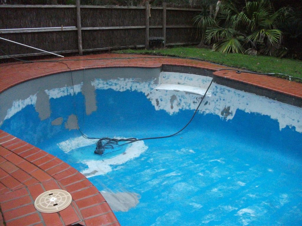

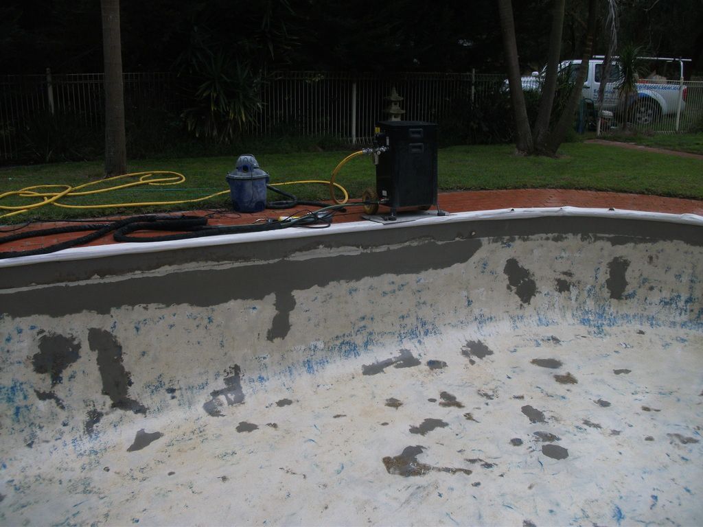

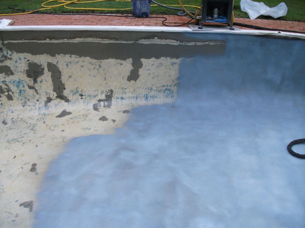

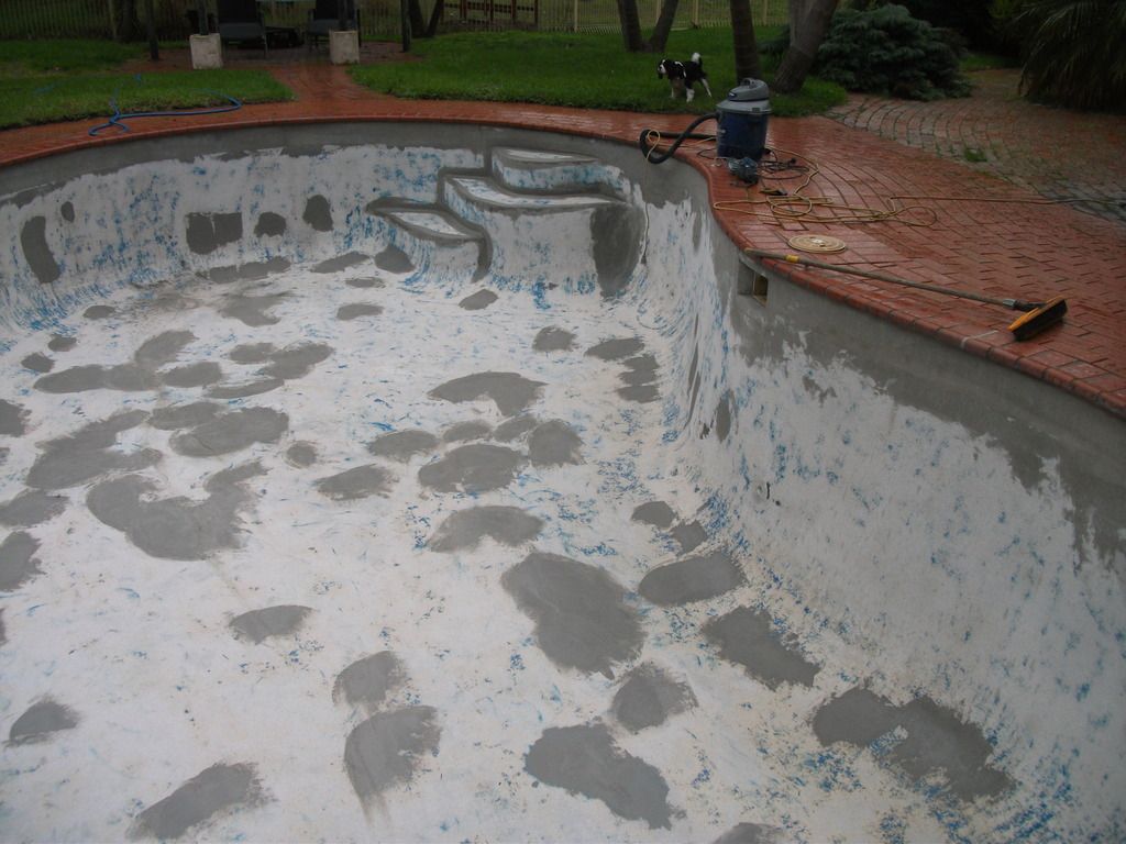

just having my pool refurbished as previous owner thought paint was a good idea
poor pool company had to grind off old epoxy paint
repair render/plaster and then paint with the eco-bright
very happy with the guys work

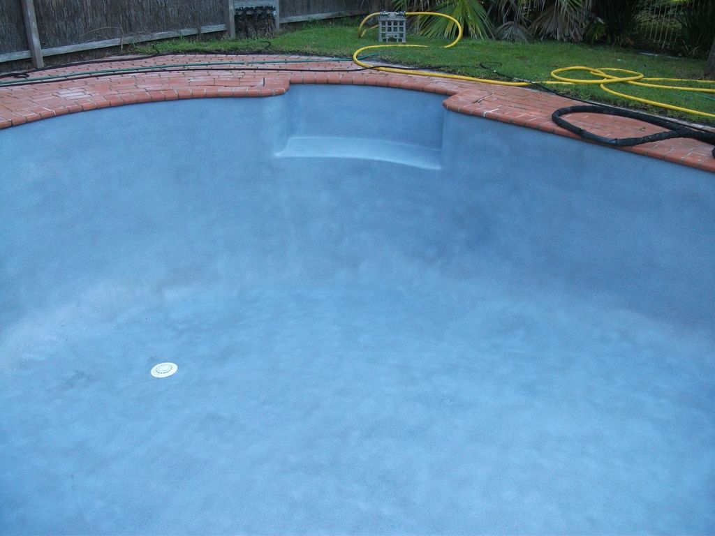

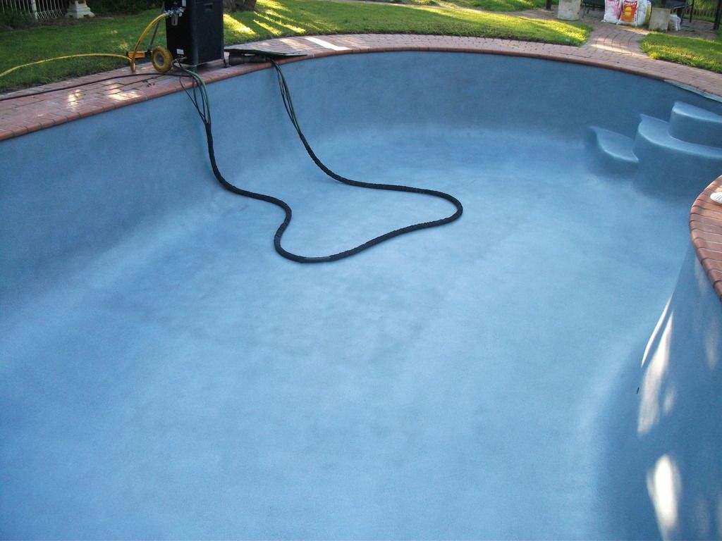

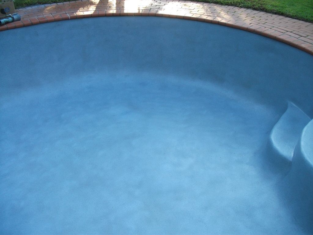

but i am unsure of the motley finish
he assures me i wont notice it when the pool is filled
but he doesn't know TFP clear water
what do you guys and girls think
I think I heard an installer on the forum say that is normal
for the blue colors...but when filled with water will be barely noticeable.
Ecofinish shading
