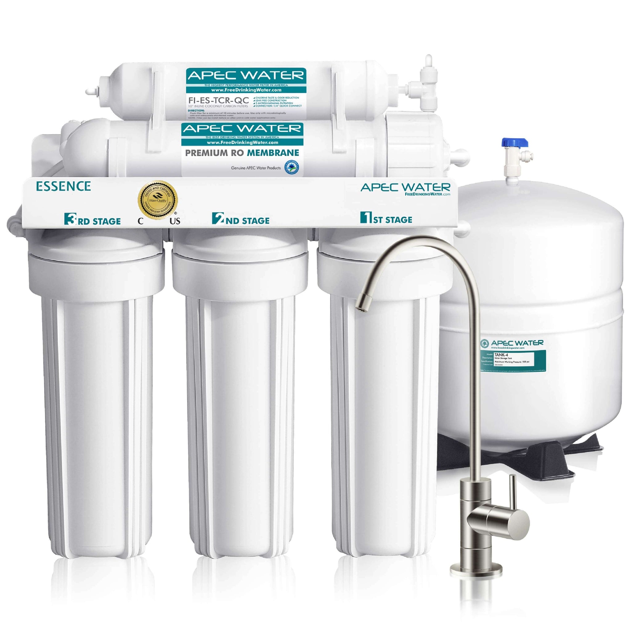

We have the one from Lowe’s and have been very happy with it. We had it in our last house then put the bigger version in this house. It’s nice to just go to Lowe’s to get new filters. Our first one was with an RO company and it was a service call for new filters.
I used this system at my old house which was on a well. It worked great. The TDS of my water went from several hundred to about 30ppm.
Our water pressure wasn’t great, so I ended up adding a permeate pump. Probably less of an issue on city water.
I was able to supply a sink-mount faucet as well as my refrigerator water dispenser / ice maker.
And I actually had the pressure tank in my basement below the sink to save space under the cabinet.
