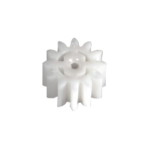

Please check your motor gear drive. It is what makes the movement. These things wear down. You need part 9983142 more than likey.

I'm having the same problem. In mine, actually the screw holding the motor gear drive was loose. I dropped the screw and can't find it. I will put back together with different M3 screw and report back.
I put in what I consider a temporary screw, a M3 that cut to close the correct length, it has a pan head and it not stainless steel. But the Doheny Advantage is working like new. I have some stainless steel screws coming from Amazon on Sunday. I think I will try a small amount of Loctite on the threads. New stainless M3 flat head 10mm screws work perfect. A bit of Loctite and robot is working great.
Trying to troubleshoot my Dolphin CC Plus. Just replaced the blue cable, tracks, and rollers, but it is still not moving. Someone mentioned (above) about the white plastic gear...where is that located? Inside the motor box, I'm guessing? Anyone can provide tips for accessing. I can see four deep recessed screws that look like they hold the box inside bot...after that, how do I get in?
