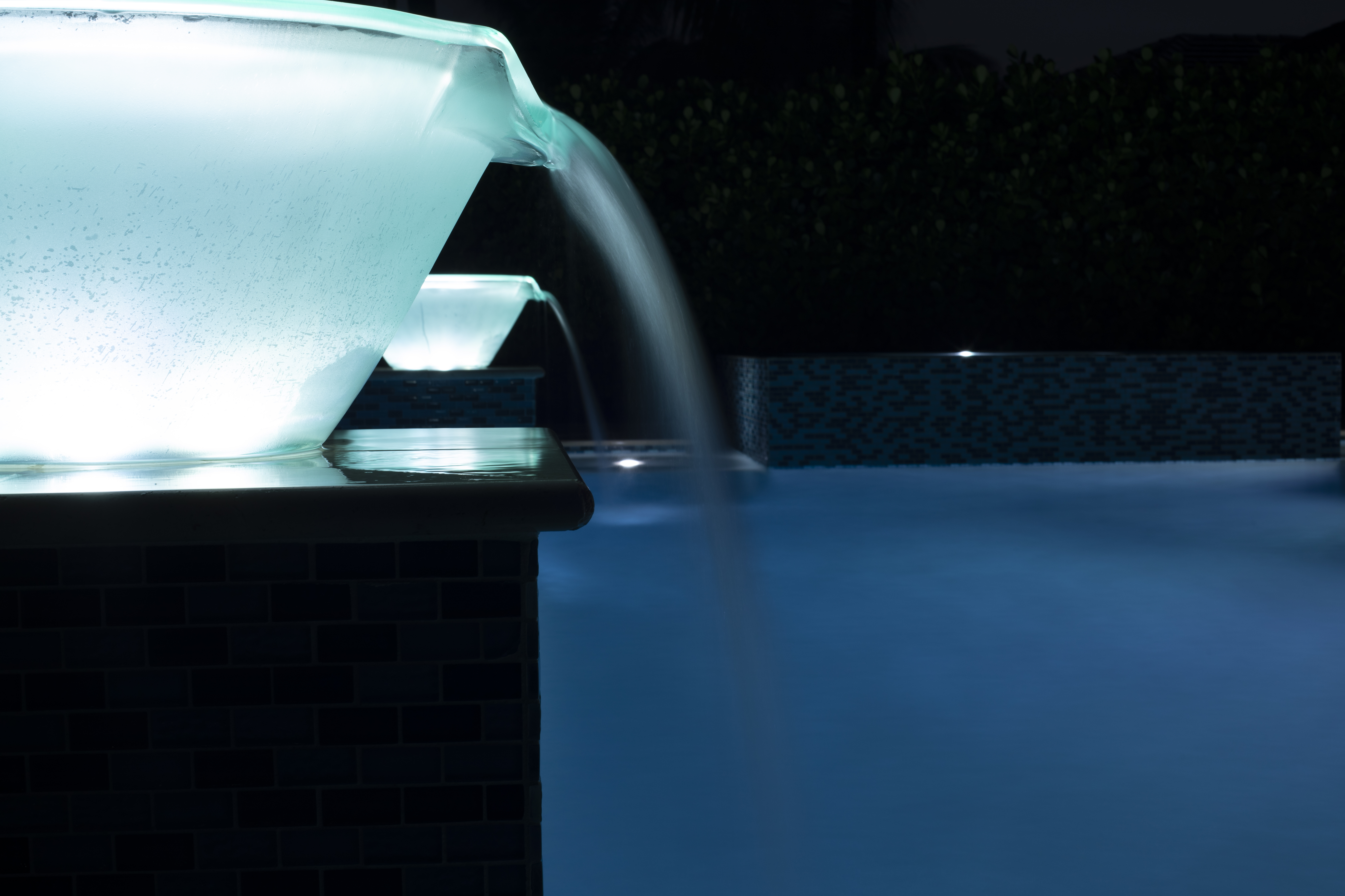

Thanks everyone for giving some good input already. Man now you have me thinking of possibly getting the following -
Maybe take out the deck jets and get two of these. I just didn't want a whole raised wall in middle, prefer keeping it open and simple and if we wanted to play volleyball or other stuff in middle can be easily done.

Dd you decide if you’re getting those light up bowls? My husband wanted bowls but I wanted a waterfall. I may have given in if I had seen those.
