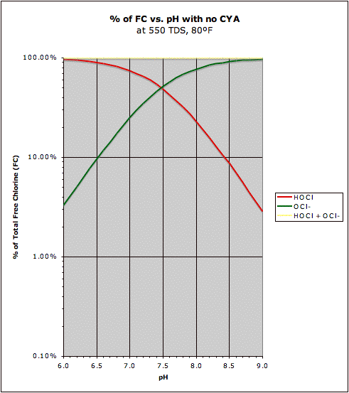

James gives an excellent formula and chart for the ratio of HCLO to CLO- given pH when CYA is not present.
My question is: Is there any way to know how that pH-ratio relationship changes given, say, a set amount of CYA?
Thanks!
Do you mean this:
Do you mean this:
Unfortunateky, tgere are two graphs missing which answers the OP’s question.
The graph on the left cannot show the 0% flat line for Cl-CYA since it is off the chart (the 0% is at negative infinity since this is a logarithmic scale).
How's that?
