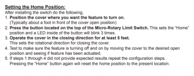

That might work if I was inclined to do the extra work. With the Intellicentr I can control the pump, lights, bubblers and Luminars, with my phone. We'll visit this maybe next summer or later.
