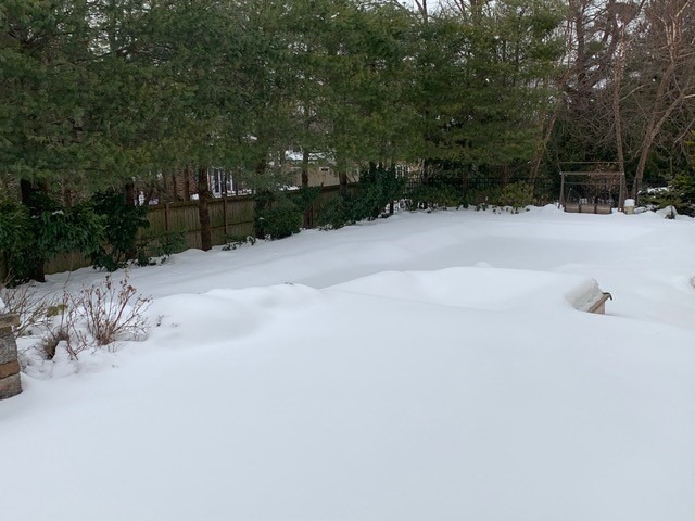

Do you know how much of a load the cover must hold when we accumulate 3 feet of snow and ice in NJ some years? I have seen how much my cover drops into the pool under the weight.
Unless you can do the analysis on the strap loads I suggest you install the cover the way the manufacturer engineered it.
What brand cover is it? Solid or mesh?
Did you take that pic in my FILS backyard !!?? :)
