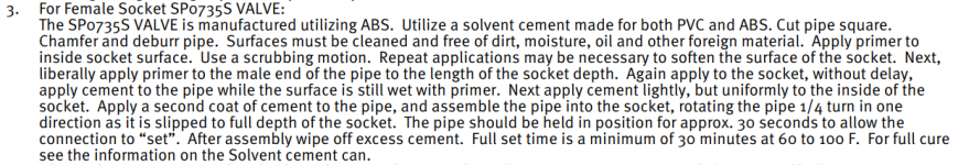

For Female Socket SP0735S VALVE:
The SP0735S VALVE is manufactured utilizing ABS.
Utilize a solvent cement made for both PVC and ABS. Cut pipe square.
Chamfer and deburr pipe.
Surfaces must be cleaned and free of dirt, moisture, oil and other foreign material. Apply primer to inside socket surface.
Use a scrubbing motion. Repeat applications may be necessary to soften the surface of the socket.
Next, liberally apply primer to the male end of the pipe to the length of the socket depth.
Again apply to the socket, without delay, apply cement to the pipe while the surface is still wet with primer.
Next apply cement lightly, but uniformly to the inside of the socket.
Apply a second coat of cement to the pipe, and assemble the pipe into the socket, rotating the pipe 1/4 turn in one direction as it is slipped to full depth of the socket.
The pipe should be held in position for approx. 30 seconds to allow the connection to “set”.
After assembly wipe off excess cement.
Full set time is a minimum of 30 minutes at 60 to 100 F.
For full cure see the information on the Solvent cement can.
