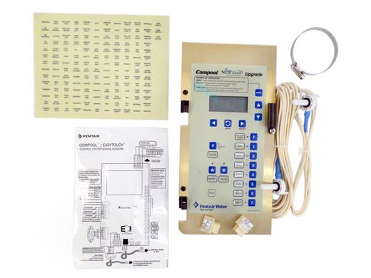

Monk,
You know there is an upgrade kit that converts your Compool unit into an EasyTouch System...
Not sure which kit you would need, but here is an example..
Jim R.
