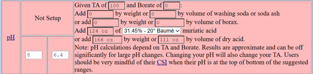

Begin to lower the TA, keep the pH at about 8.0 to 8.3 and adjust the CH to balance the CSI.
Note that as the water warms up, the CSI will increase, so anticipate this when adding calcium and do not add too much.
Get the TA down to about 60 ppm.
60 ppm TA will minimize the carbon dioxide loss and the subsequent pH rise that happens due to CO2 loss.Recommendation from the National Plaster Council on new plaster pools is a TA of 80 - 100. Where are you getting TA of 60 from?
