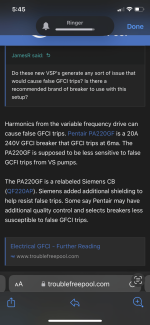

Given that I’m a novice, I drew it out to confirm this is what you were recommending.No
Yes. It will be the SOLAR relay and not AUX4.
