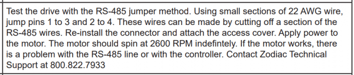

I had the same problem last week, you need to make a jumper as per the troubleshooting guide from the manual. You can cut about 5-6 inches of the RS-485 cable and open the cover of the pump and remove the existing RS-485 cables. As per the manual jump pins 1 to 3 and 2 to 4 once you finish with the connection turn on the pump, if the pump starts to work then you know there is an issue with the RS-485 connection.
