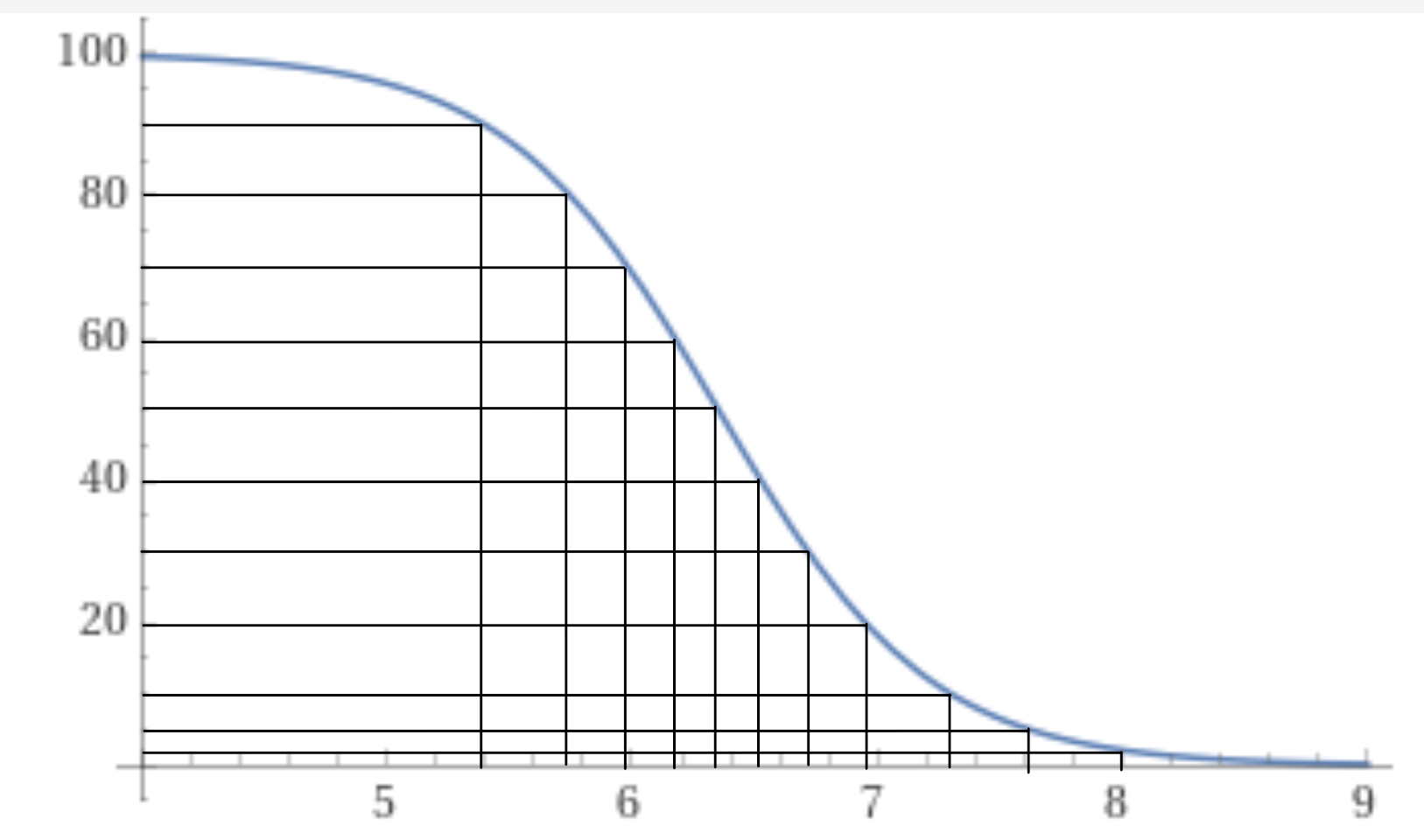

The pH does not stop until the CO2 in the pool is in equilibrium with the CO2 in the air according to Henry's law.
This also depends on the pH.
At a pH of about 7.8 and a Carbonate Alkalinity of about 40, the pH increase is very low.
If the pH is about 8.3, the CO2 is usually low enough to stop the pH rise.
The Y axis is the percentage of baking soda that converts into carbon dioxide.
The X axis is the pH.
