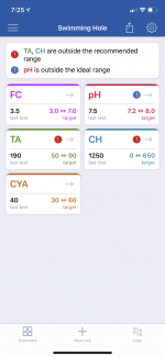

So the R-0012 drops come out super small. Way smaller than the other bottles. Is this normal?? It is giving me readings of 1250 ppm and I know my water is hard but yikes. Also, my pH is 7.5 and the pool math app is telling me that I need to raise it to 7.6 is this necessary? It is in the recommended range right?
