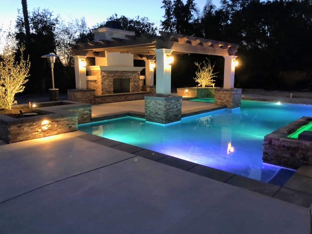

This is a pretty good example of how little light these things give off.
Its great if you have a hundred lights in your pool and have multiple colors going but for the average pool with typical lighting, you may end up disappointed.
Here the lights were installed in the sidewall and pointed toward the deck jets (which aren't on in the picture). Notice how they light up the entire shelf instead of just shooting straight up at the sky and the actual jet is barely visible. This pool has 8 Globrites in it.
This pool looks great and is probably what you have in mind but my best guess is that there at least 20 lights in this pool...figure each light is $1,000 (or more) installed.
