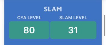

There’s no need to go to Mustard Algae slam fc levels for staining only.
If mustard algae is suspected you follow the
SLAM Process at normal slam level fc
(31 ppm for you)
Until ALL 3 end of slam criteria are passed and only then do you raise fc to MA slam level for your cya (46ppm for you) for 24 hours only.
