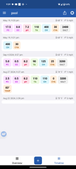

M malimited Active member Apr 9, 2024 43 North NJ Yesterday at 9:29 PM Add bookmark #1 PoolMath Logs I hope this link helps. I'm honestly at a loss I don't even know where to begin. All I know is the chemistry isn't balanced. Where should I start? Attachments Screenshot_20250519-212902.png 59.7 KB · Views: 12
ajw22 TFP Expert Gold Supporter Silver Supporter Bronze Supporter TFP Guide Jul 21, 2013 66,233 Northern NJ Pool Size 35000 Surface Plaster Chlorine Salt Water Generator SWG Type Pentair Intellichlor IC-60 Yesterday at 10:13 PM Add bookmark #2 Overall your chemistry is fine except for high FC. Your pH is fine and will rise with your high TA. Just keep your pH in the 7's and your TA will adjust with it. CH of 400 is fine. CYA 30 is a bit low. Add stabilizer to get CYA up to 60. Your salt is lower than the minimum for your Aquarite. What does the Aquarite display say for salinity? How have you been chlorinating to get the FC to 17.5? Get 5 pounds of dry stabilizer dissolving on a sock near a return. Enable CSI tracking in PoolMath and put in your water temperature to see your CSI.
