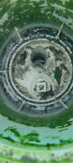

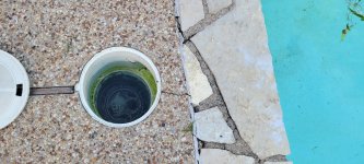

Hello,
I am a new homeowner and need help understanding how my pool works.
Both skimmers are not working, and I don't know why they are plugged in.
Are they clogged, or did someone intentionally plug them?
Does anyone know why they are plugged in and how to unplug them?
Your advice and guidance on this issue would be greatly appreciated.

SA,
Skimmers come with two holes.. When your main drain is connected to your equipment pad, then the hole next to the water is plugged.
This in no way effects the operation of the skimmers.
Show us several pics of your equipment pad, so we can give you some advice..

Hey Jim R,
Thanks for quick response.
I recently changed the filter and pump in my pool.
The water is not cloudy or green, but both skimmers are not working.
The suction hole of the skimmer line is plugged in. Can you tell me why this happened and what I should do next?

Its not plugged, its open in your picture. There should be a large basket to prevent leaves from going down the open pipe. You have that?
I have a basket in one of my skimmers, and I'm buying one for the other skimmer. However, if the skimmers are open, why aren't they working? The pool cleaning guy told me that the skimmers are plugged in, but he doesn't know why. He is saying that white plug is there insde left hole of skimmer.
Skimmers come with two holes because some pools use two but most only use one hole.
If the pump is on and there is no basket in the skimmer, its possible some debris got in the pipe and plugged it. But thats unlikely to stop water flow to both skimmers unless the pump is clogged.
The “equipment pad” is the area where your pool pump and any valves that control the skimmer are located. Post a picture of that area to help know why the skimmer wasnt pulling water.
I recently backwashed my pool. The blue hose is filled with water because of the backwash. However, the water is circulating through the main drain, pump, and returning valve.
if water is going through the system then theres only two possibilities:
1. The skimmer line is clogged.
2. The skimmer is working but just pulling very small amount of water. You can try turning off the main drain and see what changes to know if its this one.
