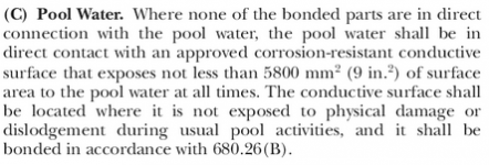

My daughter's new pool came with the following union. Is this something new? Local code also wants a bonding wire around the outside perimeter of the above ground pool. Apparently it's just in the ground & not connected to the pool frame. The installers connected a bonding wire from the motor to the pool frame but didn't connect it to this "bonding union".
