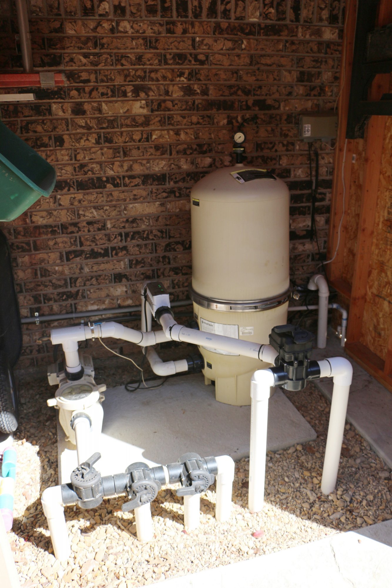

If this were my system, I would move the heat pump to the left a few feet and then build something over the rest of the equipment. It will have to be high enough and tall enough to walk in, so you can clean your filter and do other maintenance. I'd surround the equipment pad with pebble/rocks that would allow any excess water to just drain into the ground.
This is what I did..

First, I would pour a proper concrete pad for the equipment. You can tell that those premade pads you have are already moving. Eventually a pipe will crack if the equipment shifts enough. Second, not sure if you have freezing temps where you are, but it if not, a simple enclosure like the one I posted will work to keep the direct sunlight off the equipment. I agree about the variable speed pump. It will safe a ton of money, not just a few bucks, plus it won't rattle your teeth like a single speed. I'm actually surprised they put a single speed pump in on new construction in 2016. By that time in CA, they had to be 2 spd or variable.
