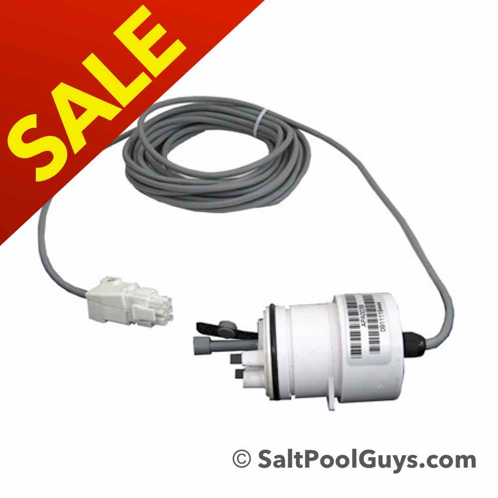

See if the salt pool guys.com has any suggestions for removing your Tri sensor

Thanks Allen! I didn't come up with any good suggestions for removal, so I ended up ordering a combo kit of the sensor and the section of plumbing that it plugs into. It wasn't really that much more expensive than just the sensor alone, and will hopefully let me get things back up and running again.
