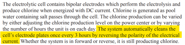

James, I validated the cell reversal here, page 8, Electrolytic Cell...reverses polarity every 3 hours.
I cannot find ANYWHERE a citation for the 3 hour "cycle" [the period used to implement the % configuration] time (except the polarity reversal) nor the support for the 30 minutes that the OP has validated with video evidence.
The Jandy Aquapure Ei, as noted in this WIKI article has a different time for the % period [cycle time] and the reverse polarity period [cycle time], see section 1.4.

The cycle for reversing polarity is 3 hours.
The on and off are described as a percentage but the time is not specified.
If you have observations of a cycle time, then I would defer to that as I have never actually timed the cycle and I don’t have any information about the cycle from Jandy.
The chlorine production can be varied by either adjusting the chlorine production level on the power center or by varying the number of hours the unit is on each day.
The system automatically cleans the cell’s electrode plates once every 3 hours by reversing the polarity of the electrical current.
Whether the system is in forward or reverse, it is still producing chlorine.
For instance, at 100% the cell is on at all times while the pump is running.
When the system is set at 90%, the cell will rest 10% of the time which helps prolong the cell life.
