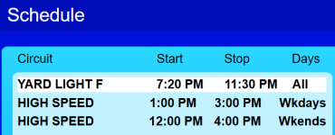

I've been struggling with how to program my pool to have different schedules on weekdays and weekends.
Even though the schedule is set to start at 1:00pm and off at 3:00pm on weekdays, the system seems to ignore the "wkdays" setting and runs this schedule everyday. I've read in other posts that it may be necessary to delete the entire schedule and reenter it. I've done this with no success.
Any suggestions? and thanks in advance.
Welcome to TFP
Can you show the entire schedule you have for the pool? It is only showing the High Speed schedule.

My goal is to increase the high speed during the times we're more likely to be in the pool. Then during the week switch to filtering the pool during the least expense time of use which is at night. What appears to be happening is that the system does not like duplicating a circuit and using the weekday and weekend variables.

There are a couple of things I see.
There a Circuilt called High Speed but there is no Speed Label with that same name. Is High Speed a One Touch label?
If so then do not schedule a One Touch circuit. Those are designed to be manual operated to perform an action you wish to do outside of the scheduled action.
You want to name one of your speed labels High Spd or something else other than High Speed so there is no conflict with the One Touch.
Then you want to schedule High Spd by going to schedule then select Add then select VSP Spd Adj then select High Spd

Well I think @MSchutzer hit upon the fix as the Filter Pump and High Speed need to be scheduled for the same time in order for the High Speed to work. The automation will always run the higher speed when 2 schedules overlap.
So set that for Weekdays. This brings up another point in your Schedule. I see you selected POOL from the VSP Spd Adj. This needs to change back to Filter Pump. So the Device is Filter Pump and it has a defined speed of Pool (1200rpm for your setup). So the schedule is Filter Pump from 12am to 6am. The pool will run at 1200rpm for Weekdays
Then set up Filter Pump from 12pm to 2pm on Weekdays. and leave the High Speed schedule from 12pm to 2pm on Weekdays. The Pump should start and prime and immediately stay at High Speed rpm until all shuts off at 2pm.
The Weekend schedule that you show should work if you remove POOL schedule and replace with Filter Pump with time of 10am to 4pm. Then the Filter Pump will start at Pool speed (1200 rpm) at 10am then ramp up to High Speed at 1pm then shut off at 4pm. This programing shows High Speed to be "inside" of the Weekend Filter Pump schedule.

Got it! The problem with the original schedule shown in the first post was that I did not have an overlapping "Filter Pump" schedule for the weekday "High Speed". I'm seeing now that these need to paired up for it to run the way I want. I'll give this another try and report back.
Thanks again
Yes. So you will need 3 Filter Pump schedules then you can schedule any speed changes with schedules that fit within the Filter Pump schedule.
Many of us run 24 hrs Filter pump - so there is only 1 Filter pump schedule and then there are multiple schedules to change speed throughout the day if needed. But since you have a weekend schedule and a weekday schedule then more Filter Pump schedules need to be established.
