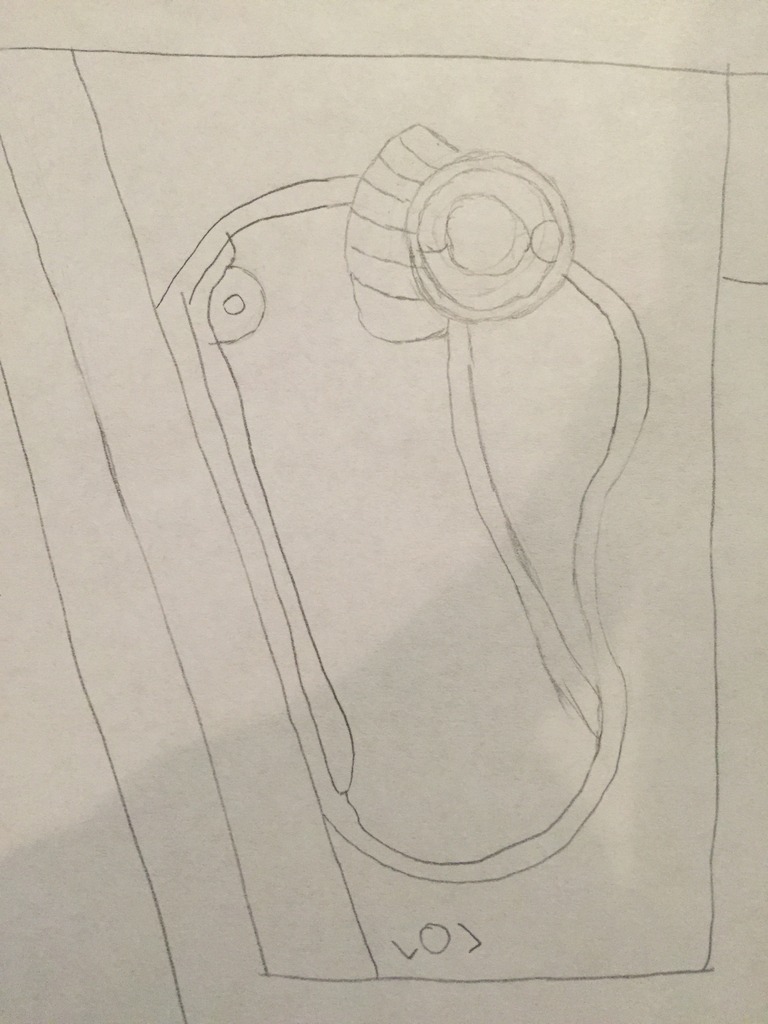

I've played with some of the suggestions but my drawing skills are truly terrible (I traced the parts that look right. [emoji23])
Help please! We closed today and I'm supposed to meet with the PB around noon to finalize details. Freaking out a little. I don't like the way either of these are coming out and I need more deck space on the spa side, not less. [emoji51]

Can you shift the pool down towards the bottom of your diagram giving you more deck space at the end with the spa?

What about steps at the top end of the pool? The top step would begin just to the left of the spa with the shallow steps reaching towards the left of the pool. They would curve and hug the wall rather than the spa. That should free up a little deck space. I will say my PB and I were both surprised at how little space the bump out took.

Here's one last option from me. I like umm's suggestion of more oval shaped spa. To me that seems to follow the designs of your pool. The round table is small enough to give accent but doesn't interrupt the flow of things. Umm may have meant this, but I've seen bean shaped spas that would really fit better into that space. BTW, in my drawing, the spa and table are meant to be round! Lol!!! I traced this from your drawings above, but just switched features. If you did the bean shape spa, you could bring out the sunshelf more into the pool giving you more sunshelf. It looks pretty big to me as it is. Those 3 features together make for some nice conversation or gathering areas.

I'm not visualizing what you mean by the steps hugging the wall instead of the spa. We're trying to keep a "swim lane" between the spa and the table. Do you mean like on that edge?

I said that was my last option, but here is the one I mentioned with the steps hugging the wall between the spa and table. The steps get shallower by the table. This would give a better shot at the swim lane. But if your husband does flip turns it won't work at all.
You have to stay with this shape due to approvals, etc, right? You can't start all over? I don't see a way to get the spa by the fire pit. Well, what about switching the spa with the table and then you have options for the steps.
a. steps hug the wall like in the drawing below
b. steps hug the sun shelf
Hmm... Flipping the table and spa might be an option. I'm not sure how big the changes can be but I think as long as we're not changing the scope or size of the pool and not trying cross any build lines that it would be okay to change it up. I wish I weren't struggling with this so much. ☹️ Thank you for continuing to give me suggestions Suz! They're helping!
I took Suz's great drawing and modified it slightly. If you go with an oval spa (I know you don't think it goes but I really do think it does. It will allow you to turn it to get more deck (I didn't do this much) and make it easier to fit your exercise thingie without having to make a perfect circle huge for something that is rectangular. I also moved the steps to follow the spa so the swim lane is still present.
Here is another oval spa... I did a horrible job with your original design but you get the idea. I stretched the spa and narrowed it on the other axis. i pushed the spa farther into the pool that gives you way more deck. I pushed the steps and swim shelf over because of the spa movement.

Another option is to think outside of the box a little. Your spa takes up a bunch of space width wise because you have a bench that goes all the way around (plus coping). If you elongated the spa and did something like this you could get the same amount of seating BUT at the same time not adding much to the overall width of your design... (I found the image on pinterest).

You have to make the spa more elongated to have the same amount of seating. In your design the difficulty is the width. You have 38' of length to work with but the width is limited.
Plus with a circle you are limited by the inner most diameter of the seat. You can only fit so many legs in there.
Let's say the inner diameter is 8' - 36" (18"x2) = 5' inner diameter. That is 15' of circumference (Pi*5) of your seating on the inside. Now make the inner seat diameter 8' and then have 3' to the wall on each side roughly that is about 14' about the same inner diameter. You can stretch even more if you want.
To help you get everything you want into the design, I'm back to the suggestion of either sliding the pool down to the bottom of the drawing or better yet (for me) stretching the pool down there and giving a little bit more length. Also, stretch the pool wider out near the bottom right of the pool where it notes 5'8" on the diagram. Leave enough room (3 and a half ft) to walk or put a chair just for watching kids in that area if you needed to. To me those could be wasted space. Keep all your people either in the pool with all those benches and/or at the top deck area with the table and fire pit.
