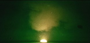

But now, here we are on the 5th day, and while the water is "clear", there's still algae in there. Its a bit cloudy when looking from one end to the other... and I can still find some algae in the divots of the steps. And then there's these photos I took last night.... they're actually screenshots from a video. All within 10 seconds or less. It was as if someone had poured something into the water and it was spreading out... what is this?????

That's odd, but I have a gut feeling the algae you got was a coincidence to the filter work and not directly related to it. No doubt the play sand was a major no-no, but the zeolite (IMO) was not the best replacement. But we do have many fans of it here as well. In any case, you confirmed algae so the SLAM Process is the way to go, but now you have to be vigilant everywhere in the pool and not just think the filter was the source. Algae could be hiding anywhere. There debris you see under the light might be dead algae blowing back into the pool, hard to tell. Hopefully your tech didn't damage a lateral during the process resulting in zeolite blowing back in. Maybe see if you can capture some of it from a return jet?
