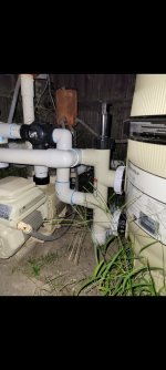

You might consider posting a pic or two of your equipment pad. It may give us additional ideas.
Here are some pics. The old pump was 1 1/2 hp as well. It was operational but clearly on last leg because the new VS pump results in much stronger flow.
Maybe I will add the prime setting back (some how I accidently turned it off when changing other settings). Didn't realize that could be a problem.
Thanks for the input. Just started taking on the pool job myself after a complete replaster, coping and tile job, so I'm having fun adding acid all the time and using my TFT kit!
On the suction side it appears fairly straight-forward. Looks like you have 3 manual valves which have the potential to leak air with age, but if your previous pump did not have this air issue those 3-way valves may be fine. You mentioned that you added lube to the pump lid O-ring already, so hopefully the drain plug(s) are lubed as well. So on the suction side, that would only leave the union nut attached to the pump's suction input as a questionable issue. You might check that once again to ensure you have a good connection with no possible air leak (going in). Other than that, once you get past the initial priming stage, you may just be experiencing variances between the two pumps (young & old). We'll see if others have any other tips or suggestions.
