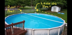

I have a center reel on my 27' round. It is aluminum tube, about 1/4" thick walls, maybe 5" in diameter.
It has held up pretty well for the last 3 years. It spends the winter with the full weight of the cover on it. I store it on two "landing" posts off of the pool in the winter, with the solar cover rolled up on it, and the whole thing wrapped in tarps, like a giant, blue, burrito.
My old issue was that the sections are held together by inserting expanding rubber plugs into hole you drill (you crank down a bolt in the plug to expand it). After two years they deteriorated. I just cross drilled the tubes and used stainless bolts and nylocks and it works just fine.
It does deflect slightly in the middle, but not enough that I worry about it.
I used to use the saddle holder that others pictured, and I find the reel much easier.

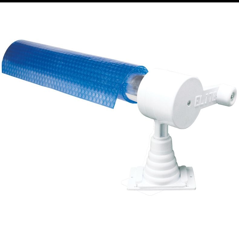

This is the one I have, I don't know if they make a 30'
