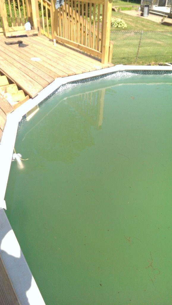

How about taking some pics for us. The pics will also help you when it starts to clear. Take one of your steps. If you take one a day of the same place we can all see the progress.
Keep working on getting all of the junk out of the pool. The more you get out the faster your SLAM will go.

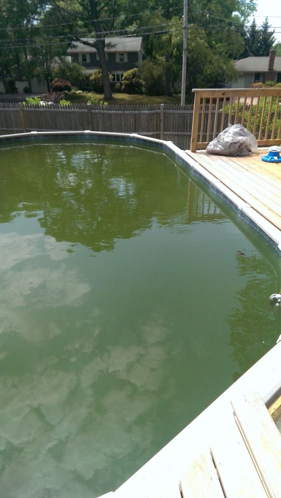

Hope I did the photo uploading right (URL above). One pic was at the start of slam, the second when FC was 7.5... And if you look at my earlier post, you'll see the swamp I started with. All that was missing was the alligator.
Will continue to upload as I make progress.

Let's see if this posts both pics...
