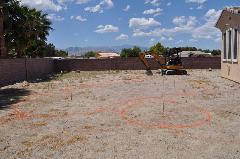

How's this for a turn in luck, new excavator showed-up today wanting to outline pool and drop off his equipment so he can get an early start on Monday!
That is a wonderful turn of luck! How do you feel about the outline? Did you take a pic of it to show us??????
We're concerned with how close it is to that corner of the house. Spoke to excavator and he said he could move it two to three feet away. We left quite a bit of room behind the pool for a gazebo and putting green otherwise we would have pushed it back more.
After talking about it last night I believe we're going to eliminate the second wet deck and turn it into a bench. Pool just seems to narrow.
Overall it feels small to. It's 36 x 31 and 26,500 gallons. Did others have this concern when their pools were laid out?
Excavator came by today and said the reason he laid the pool out two days before the dig is he thought it might be too close to the house for our liking. So, we're pushing it out two feet from the house and we're going to push back 3 feet. Just thinking we may want more decking near the house, still have plenty of room behind. If we end-up using the space we have two side yards that we can always put the putting green on.

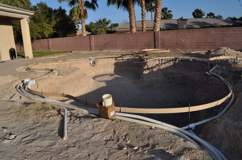

First hic-up, had to leave town 1/2 way through excavation which wrapped yesterday. Plumbing is starting this morning and it appears that the excavator forgot to dig one of the two skimmer notches. Ugh, talked to him last night and he said he'd come back today and do it . . . actually he said I didn't have two skimmers and I told him they're clearly on the plan and all the other subs noticed them. He left his bobcat there so he's got to come back, just hope he doesn't give my wife a hard time about it. He knows most of the other subs I'm using so I'm hoping there's also a sense of professional pride and embarrassment that he missed something so obvious.

Wife got on tractor and dug it out herself . . . Kidding of course, my plumber just had one of his guys do it, took him 20 min. Still not sure why I have two skimmers.

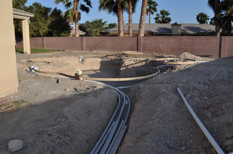

On the plane on my way home, wife sent me several pictures, looks like plumber made good progress today.

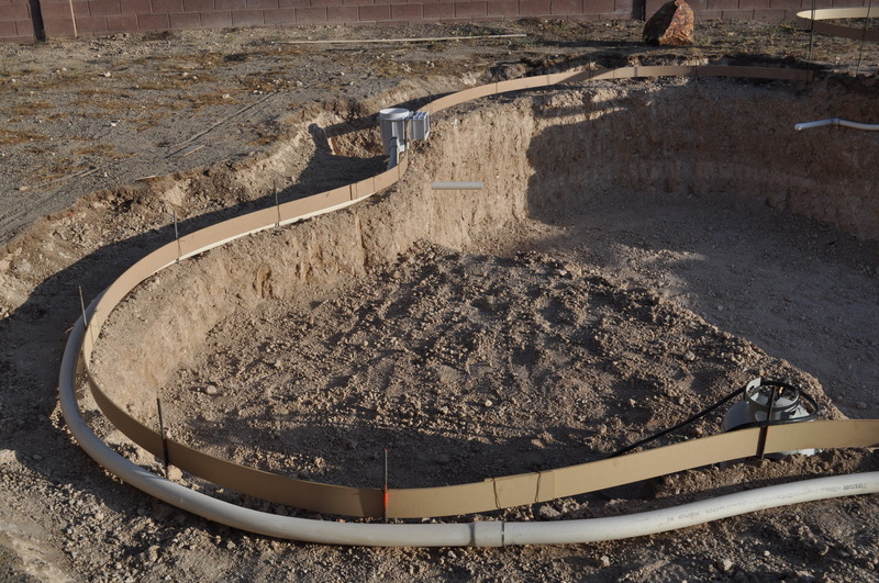

Returned last night and took these pics. Looks like they're making good progress, plumbing will be done today and steel guy should be here later. Really like the plumber I'm working with, crew was on-time, he communicates well, upgraded the lines to larger sizes for me at no charge.
