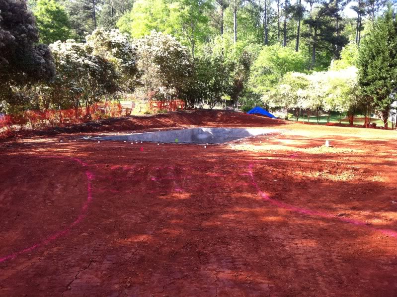

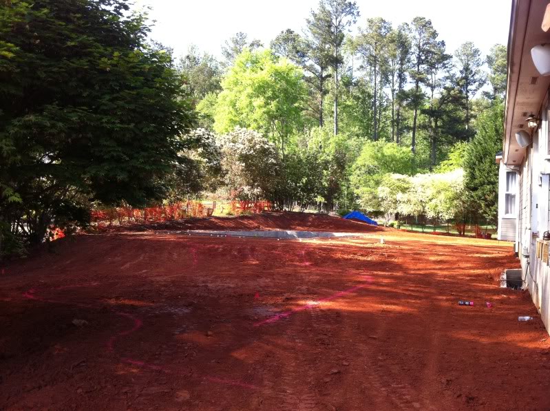

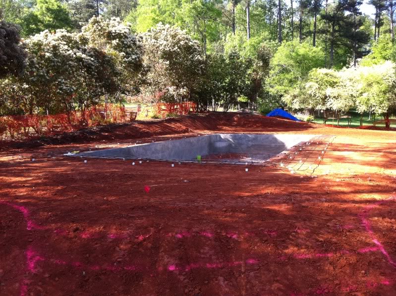

Took a few more pics last night. They don't really show the changes in elevation (mostly cause it's all red clay at the moment). The now flat space next to the pool really makes the yard look bigger. I measured that area last night, and giving up some space by the pool deck, and the future fence, i could do a 25'x50' volleyball court if i wanted (official size is 30'x60' i think).
Volleyball area possibly

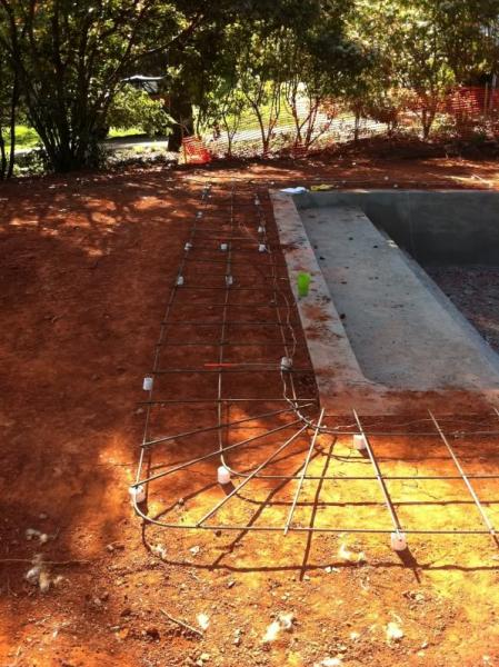

Somebody swung by yesterday and finished the bonding, forgot to see if they pressurized the lines, guess i'm ready for inspection.
Also painted out where i think we want the pool decking and concrete patio to go, as well as the connecting steps. Concrete foreman comes over today to talk about the pour and finalize where the forms will go.
In case anyone is wondering, these pictures were taken around 5:30 pm. The pool gets full sun from about 9:30- 4:30 currently.

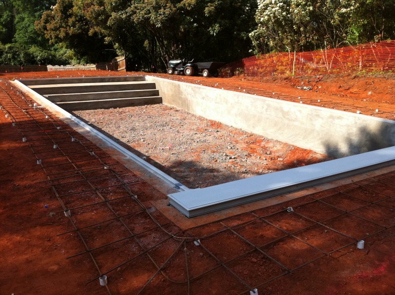

Coverstar came out over the weekend and installed the auto cover's track and pit cover. The installer was real nice and explained a lot about auto covers too me, pro's con's among the different brands. He was glad the pool was built perfectly square as the tracks don't flex to make up for minor errors. He did have to shim the pit cover support on the pool side of the pit because the pit was formed 1/2" too wide ( i guess that's better than 1/2" too narrow....)

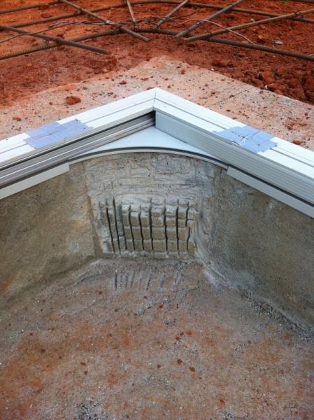

So the pool builder has made 1 mistake, he told the head gunite guy 5" radius in the corner and head gunite guy heard something else, so the 4 corners have to be ground down. PB came out the other day and did the top couple inches so as to not hold up the auto cover guy, he said when they do they pool bottom his guys will finish the corners....

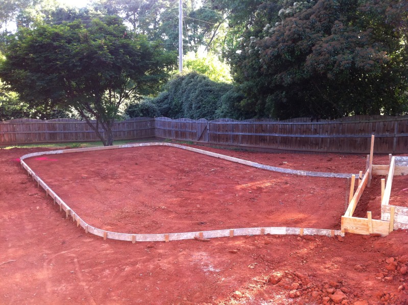

Concrete forms were put up yesterday. Sure looks different than the pink spray painted lines. Any opinions? Now is the time to change it!
The hot tub pad drains towards the pool, there will be a channel drain between the pool decking and hot tube pad. It is supposed to have 1" of fall over 9' so that it's not noticeable in the hottub.
The Pink corner needs to be square, the stairs will land along that side, the rounded corner would be hidden and just require the stairs land 1' further into the patio.
Everything (except hot tub pad) drains away from house.

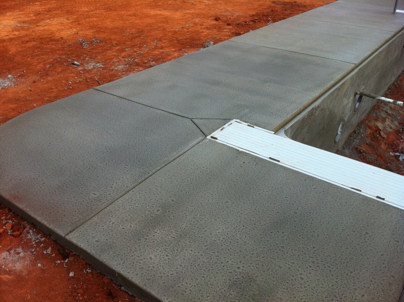

After I was able to walk on the concrete and inspect it from the pool I noticed something I am not happy about. I asked the PB about it and he said that's the way it's supposed to be, something about sponge finished....at any rate there is exposed aggregate in the coping, specifically the cantilevered part of the coping only, where the aluminum form was. Here are the pictures
Now maybe that's as good as can be expected. I have to admit i haven't seen any other pools with this type of coping in person for years, so I don't know. It does however seem really rough, and if you rubbed you body up against it you will get scraped.
The other issue is these two corners don't look right, there was one continuous form that went around the 3 sides getting coping (1 side is pit for auto cover). It looks like after they took the form off somebody took a scoop of concrete and stuck it in the corner with their fingers, but who knows....
I've already done some research on concrete "sanding" so i realize it is possible that i could get some diamond grinder cups for my angle grinder and go at it once it's cured a little longer to make it so I won't come out a bloody mess after leaning up against the side.....but along with grinding comes the risk of hitting the embedded auto cover track, or cutting smiley faces into the coping on accident when the disc grabs too much.
At any rate the PB currently is dismissing my concerns, and saying my concrete job is in the top 1% of those he sees.....

I have not seen cement cantilever coping on rectangular corners, but on radiused pools they don't have transitions such as that. To be honest that looks fairly poor. The only cantilever rectangulars I have seen use a Bull nose brick or stone in the corners.
My Coping on my free form pool (first one I had built prior to moving) had smooth cantilever edges with little to no aggregate exposed.
Most grecian or rectangular pools I see with rolled over edges use bull nosed type bricks. That is how my grecian I currently have it done. I am sure someone has this style and will be a long shortly to comment!!!
Well anyone have experience/suggestions on smoothing it out a little? Grinder/diamond cups? Wait till it's good and hard so I don't knock out the aggregate?
I'm guessing I'll probably have to live with the corners, might be hard to get in there with a 6" circular blade. Not sure maybe a good rotary air tool would work with a smaller blade.
Guess I'll need to research a bunch and see what tools are available.
Looks like the form was removed after concrete had set. The forms should have Been taken of and finished with the deck. I am about to do same cover with coping forms myself. Not shure there is a good way grind it down. Some type of top coat may be best.
Melt In The Sun said:
I think the responsibility for fixing that lies with the pool builder.
Pool Builder told me that was the way it was supposed to be, that it was normal. The concrete guy must think it's acceptable as that's the way it was done. I agree it looks like they waited too long to take the forms off, then the couldn't finish it without screwing it up so the just tried to do the best they could with a bucket and sponge. I think the corners are like they are because when they continued the rub joint to the vertical surface of the coping they knocked cement out of the corners, and just put it back with their hands, which is why it's not perfectly square there like the form was.
I don't see too many options. I can insist they try and fix it. How? Cut it out and repour? I don't know if I want that done.
I've been reading about how these guys that pour concrete counter top's finish their's, that's where i got the idea about diamond cups and grinder. I think something like that is a good option for all the sides, just not the corners.
Maybe aluminum coping could be installed over it? But isn't that usually in place and then poured into?
The other part of me thinks, am I goning to ask a guy who think dog poop looks like a hot dog to fix this?
I would want them to cut it out and redo it for a couple reasons. One, the edge looks like garbage, especially that corner. Two, it's a good idea to have the coping separated from the deck by a movement joint. Otherwise you will end up with a crack about a foot back from the edge of the pool as the shell moves differently than the deck.
