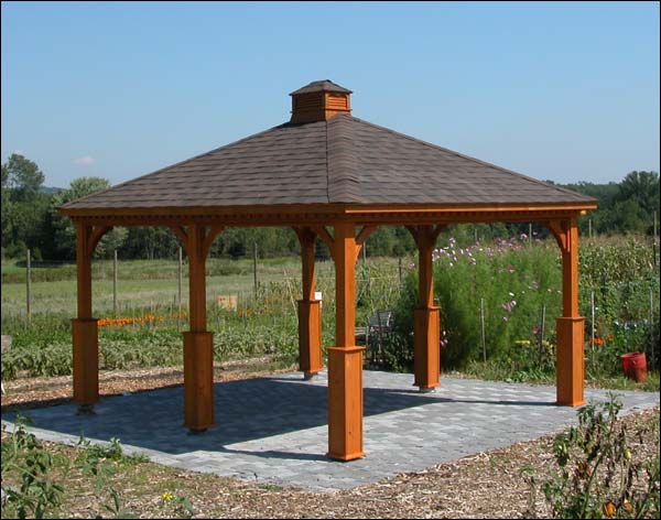

Sorry I haven't updated this in a while. There hasn't been much activity regarding the pool build but tons of stuff related to our other subcontractors. During this downtime we received bids from 2 builders for the construction of a pavilion.
The first guy (a landscaper) wrote up a a bid that included a 14x14 structure, hip roof w/ 30yr shingles, pavers, rough sawn cedar, and a few other flourishes. Total cost +14k. Upon request he also submitted a +7k bid for a fire pit and sitting area. :shock: After waiting a week+ to get his bid and then seeing his final price we were just about ready to throw out the pavilion completely but I was convinced we could pull this off.
I went down to a local lumber yard that also builds small sturctures such as sheds, barns, etc and gave them my specs to see if they were interested in the business. Apparently their construction business revolves around selling corregated siding/roofing. My HOA would never allow that material on the roof so they couldn't build the pavilion. However the secretary indicated that this isn't the first time they've had to turn down work and she recommended me several roofers that they consult with that could build what I was looking for. The first guy I call comes out to the house takes a look at the yard and listens as we describe the features that we want. The guy then proceeds to draw the structure on un-lined printer paper better than I ever could on a green engineering pad.
The end result:
- 16'x12' pavilion w/ long side facing the pool
- 8' high eaves wrapped in trim to match house
- 5 - 6"x6" pressure treated posts (2-front corners, 3 along back),
- wood molding/trim to wrap the posts
- 30yr archit. shingles to match house
- Roofing done w/ T1-11 groove side down (we'll paint or stain it after construction)
- flooring to be concrete (same as pool deck)
- All construction to be done in his shop and assembled on site once yard grade info is communicated via pool builder.
- Total under $4k. :goodjob:
I tried to find an example online but this is the best I could come up with:
Note: We'll most likely paint our posts white and our pavilion won't have a cupola on top. I'm sure ya'll get the idea.

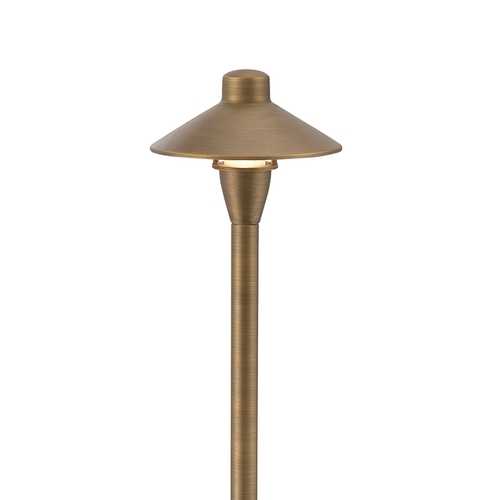

- Run a separate circuit to a sub panel & transformer (mounted on rear of pavilion) for 6-8 low voltage landscape lights. Something like this:
I think these are from a company called Brass Works (similar to CAST). I'm hoping they're a bit brighter and more durable than the solar kits from HD & Lowes.
