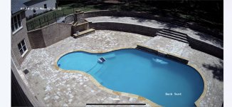

This is what the water looked like last Monday. Not brown, or swamp green like some pictures I see on here, but not clear either... The main drains were completely invisible, even up close. You can also see I had a chlorine floater....after reading up here, that is now gone.
