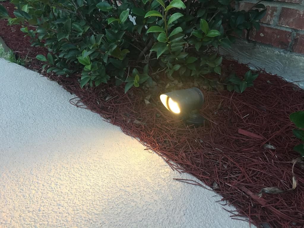

They’re really small, so they’re easy to conceal, and they don’t have to be wet to leave them on (unlike some other underwater lights). We went with the 2700K, which was a special order, but have a much warmer look than the standard 3000K. Later, I added a VOLT® All-Star™ Cast Brass Spotlight for a spot light on the slide, shown below, but these are really common among other manufacturers, unlike the underwater lights:

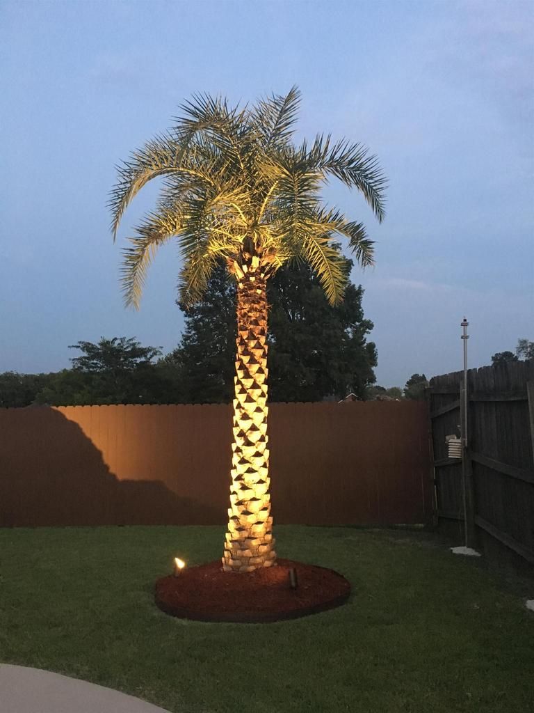

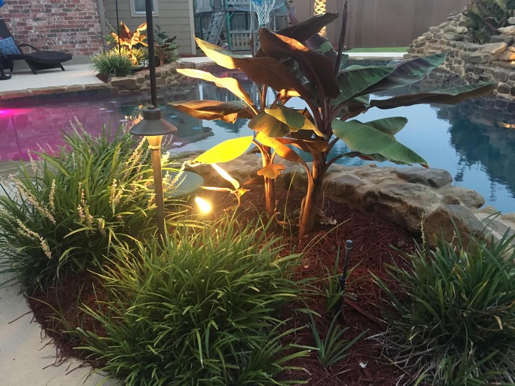

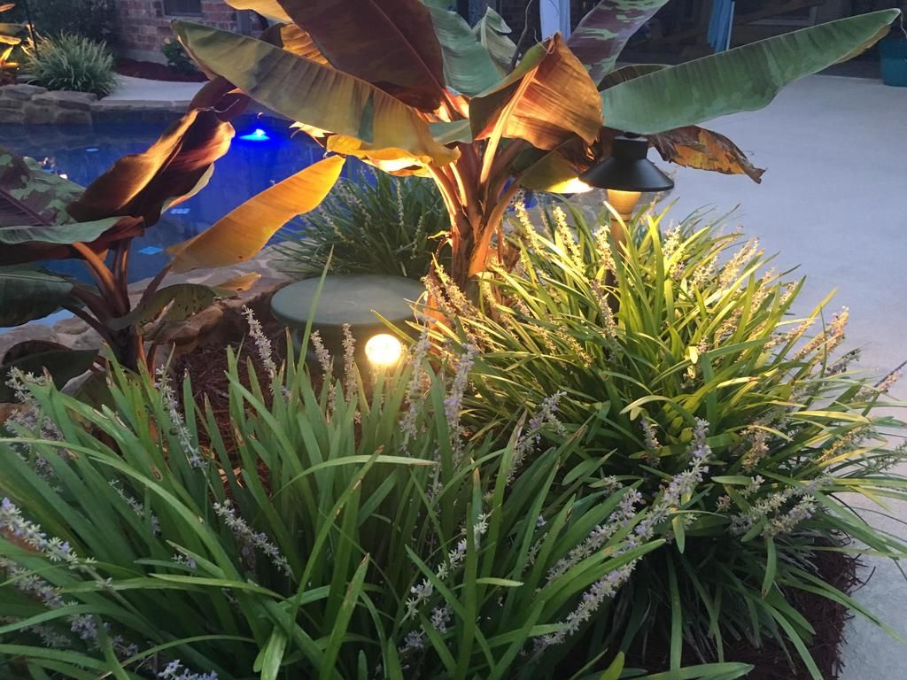

For my planters I used the VOLT MINI China Hat Path & Area Lights for area lighting and the VOLT® Infiniti™ 30 G3 Brass LED Spotlights for some up lighting on the plants (which are nice because they’re really compact), shown here:

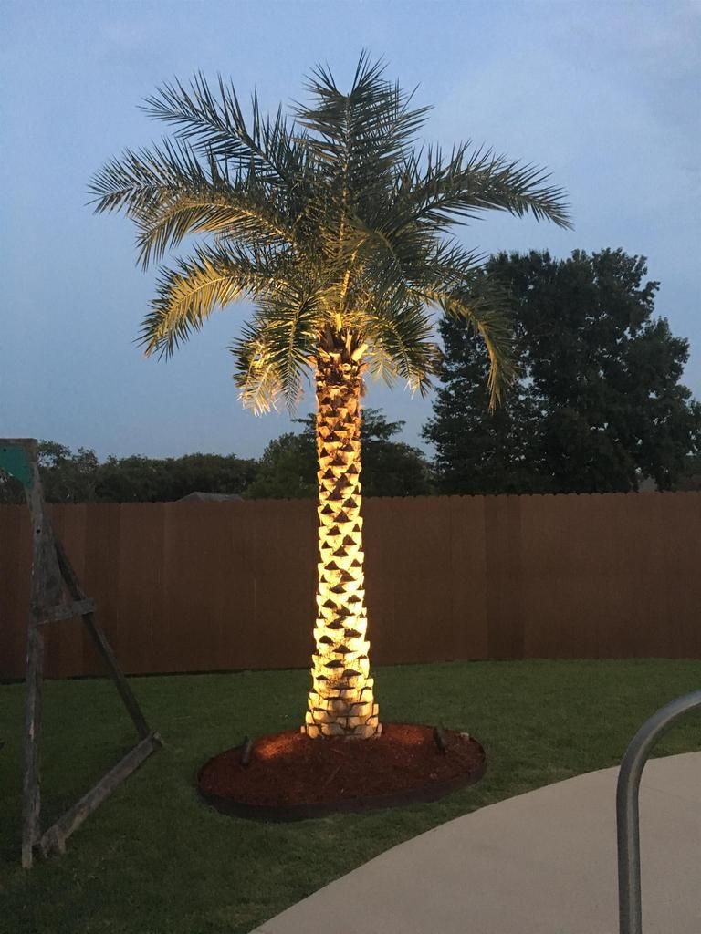

For the palms (and planters on either side of the waterfall, but they’re hard to see right now), I used the VOLT Fat Boy Lights, shown here:
