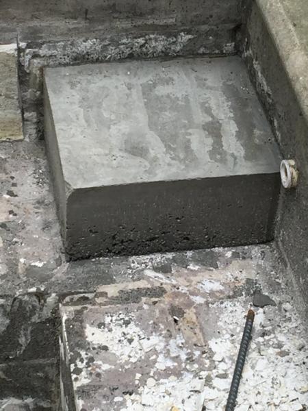

We have a step! Let the curing begin!
Note the lovely return that prevents the new step from being the same size as the existing. [emoji33]

That corner is no issue since it will get plastered before the AB. You don't want a sharp edge anyway, all the edges should get chipped just like that corner.

Hi Brian - we are actually tiling the steps and the bench. I didn't want to take up anymore space on the bench, as it's the only good place to sit in the pool, so decided for the small step atop the existing. The return falls almost in the middle of the edge of a perfectly sized step, so we decided to go just to the left of it. It's also too high to fall within the step. It would have been nice, I agree, to have incorporated it!
