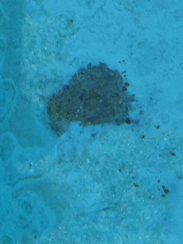

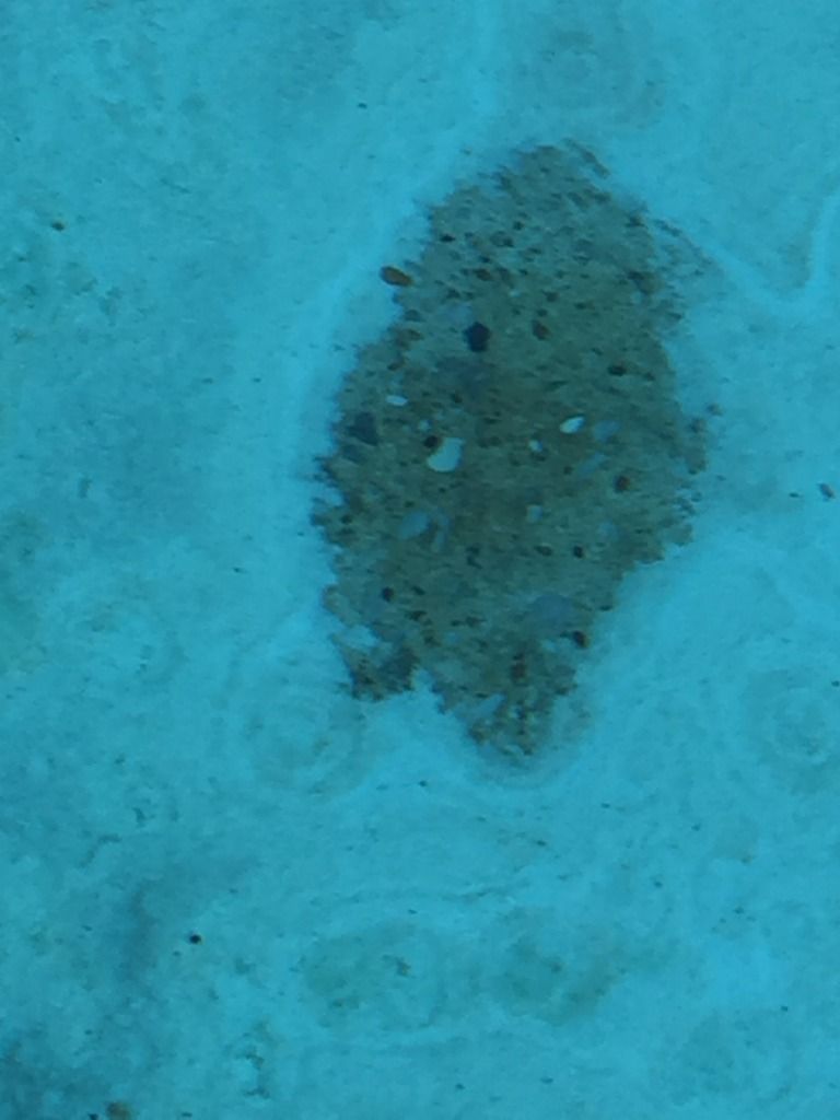

After getting some of the staining out, I've noticed spots where it appears that the plaster has deteriorated to the point where i'm seeing concrete aggregate. Cosmetics aside, how bad is this in terms of needing a replaster? There's no leaking that I can tell. My main concern is any impact this may have on water chemistry and damaging the new heater.
