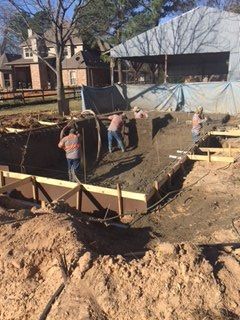

So dig was completed yesterday and steel went in today! Only concern is that our soil is extremely sandy and there were a few cave ins they had to take care of which left pretty good gaps (should this be a concern? Gunite coming next week). Here are a couple pics.
Not a concern for you, just for the PB. Happens all the time and is hand shoveled out and possibly placing up backer boards to shoot against.

Thanks bmoreswim. This is an owner build so I wasn't sure how big an issue (although reading some more, it does seem to happen a lot as you explained). I OB'd my last pool but had much different soil so it wasn't an issue.
Ah, yes I missed the OB part. Doesn't look like the fallout is too bad though. Just a little extra manual labor by someone.

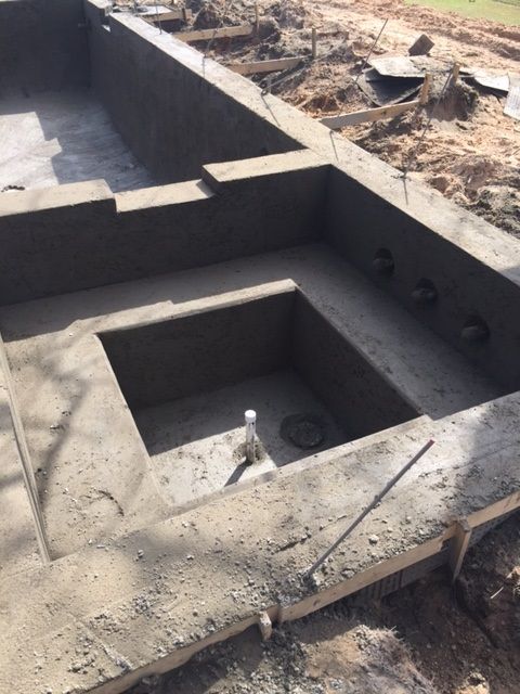

After a threat of rain (and concerns of dig collapsing) we were able to shoot gunite last Friday. Went to order tile and coping today and should have complete next week. The company going the tile, coping and plaster are asking for 50% up front. Is this fairly common? I've had the hole dug, steel, plumbing and gunite and none requested any payment up front.
